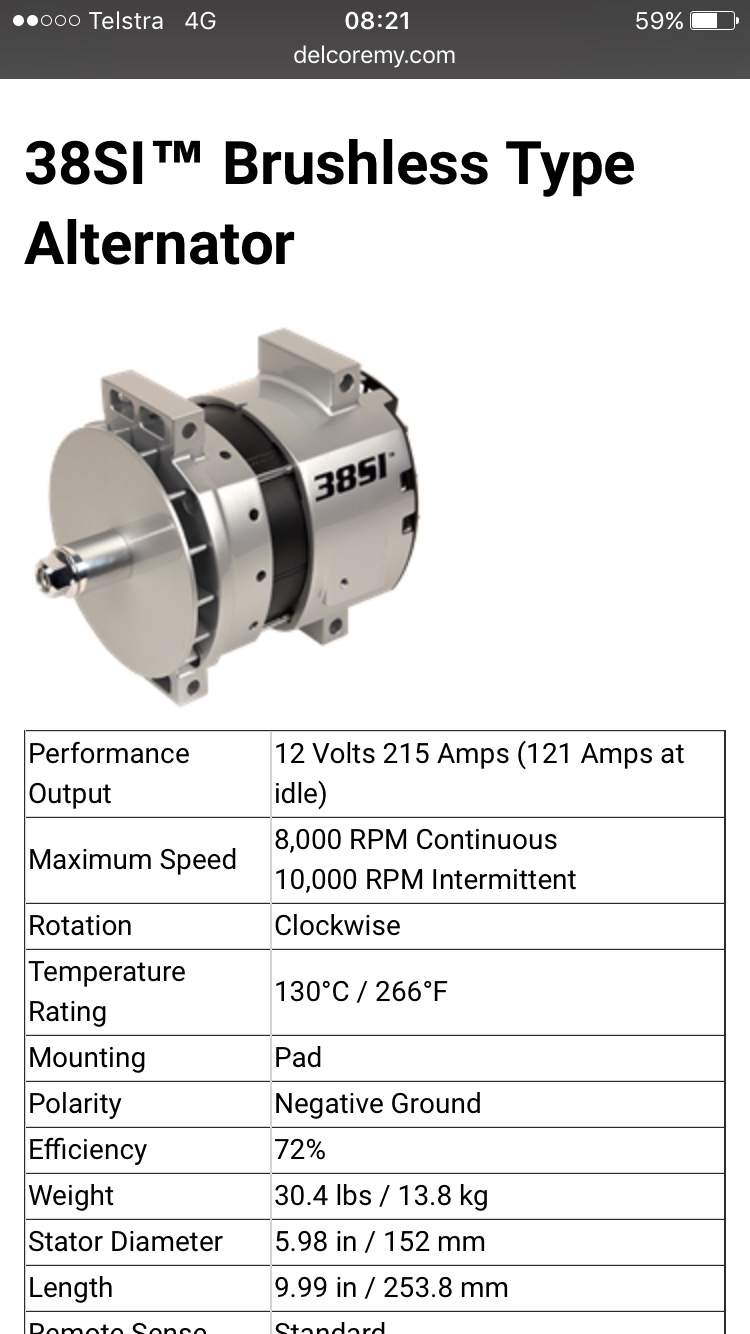

    Think I might have found my dream alternator gents and bulletproof too they reckon :-)!
    http://www.delcoremy.com/getmedia/37...-6-16.pdf.aspx
    215amps with 121amps at idle.

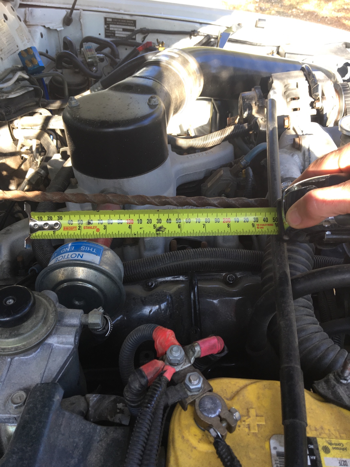

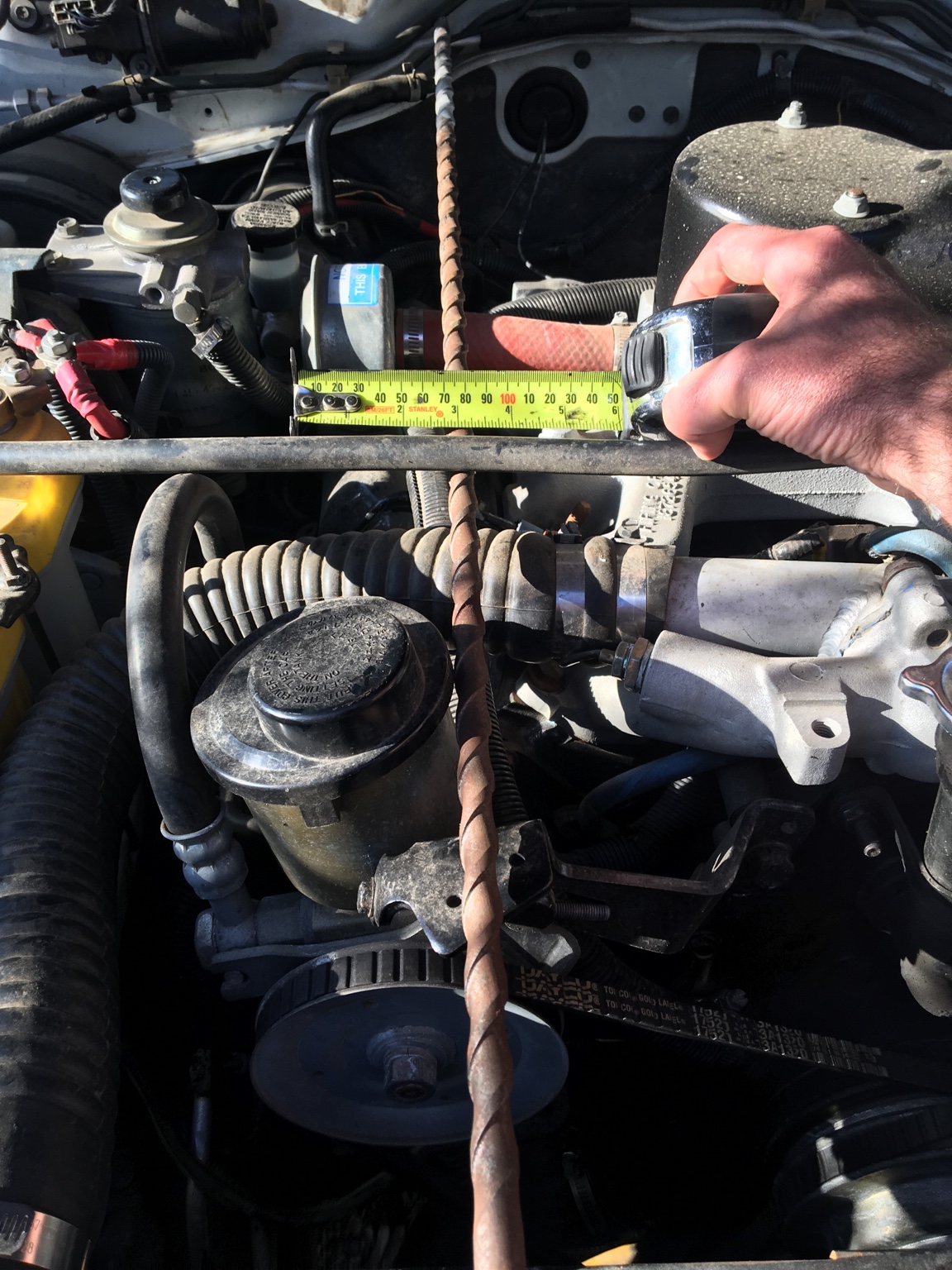

    It is bulky but measured it up this morning and in theory should just fit drivers side behind the power steering reservoir with a 200mm supported extension shaft to pickup the existing Mitsubishi alternator V belt inline. 121amps at idle should power the 6hp Warn/Mahle motor no sweat :-)

    I thought I was the only one setting myself next to impossible tasks! Good luck with this one Mark, the brackets are going to be a head twist, especially mounted off the engine and with the shaft extension. Make sure you use self aligning bearings/pillow blocks i reckon and these need to take the belt tension, so the alternator shaft doesn't see the tension load at all. I look forward to your adventure!!!! I am guessing the config is something like pulley, then a pair of spaced pillow blocks on a plate, shaft coupled to the alternator, would probably go for a coupling that allows for minor misalignment.
