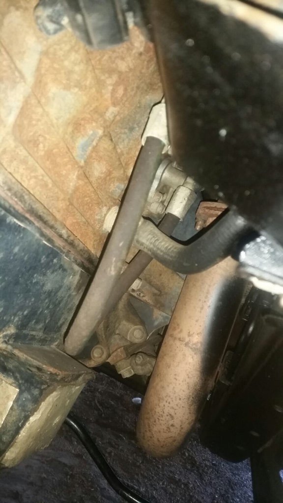

    You can see my Oil drain slightly in one of those pics. However I am using the larger frame turbo than you guys and it all sits further forward. I just used the drain hose that was with the UFI 18G I had prior.
    So in the pic you can see the Water feed out the side of the block looping down then back up to the turbo yeah?
    The hose with the formed bend in the middle of the pic is the Oil line and just needs to be a suitable oil hose with hose clamps?

    Yeah but you really want a nice flowing hose to your sump. You do not want any restriction here with twists or bends or restrictions otherwise you could end up like me potentially.

    Mine.......
    Too tight or not enough room for error to go above the oil drain line running the water feed with that system?
    I used heavy hose and it doesnt bend well. That hose is rated to over 5000psi
    Also using a bigger frame turbo which puts everything in different places.
