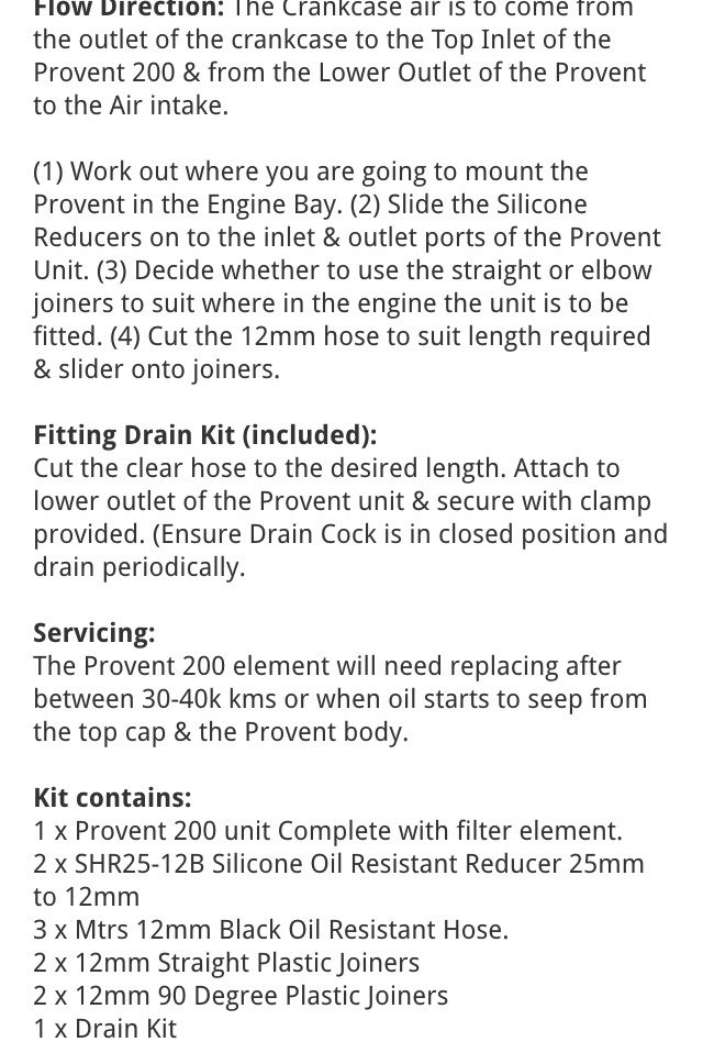

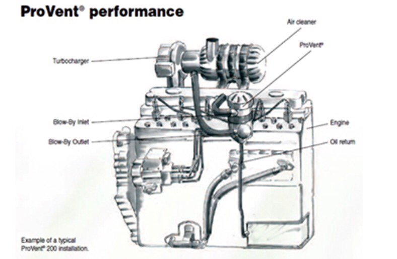

    Hey mate i have to agree, iv been searching for this very issue. I have the stainless mesh version, arrows say in top out bottom but as others have said oil goes down and accumulating then to drain, BUT as this captured oil is going passed the outlet to the drain its getting sucked back through system. It would make sense to have the heavy wet side in the compartment that goes to drain, (more surface area on lower can body to cool) allowing the cleaned lighter air out the top.
    ive just swapped my hoses to outlet top.
