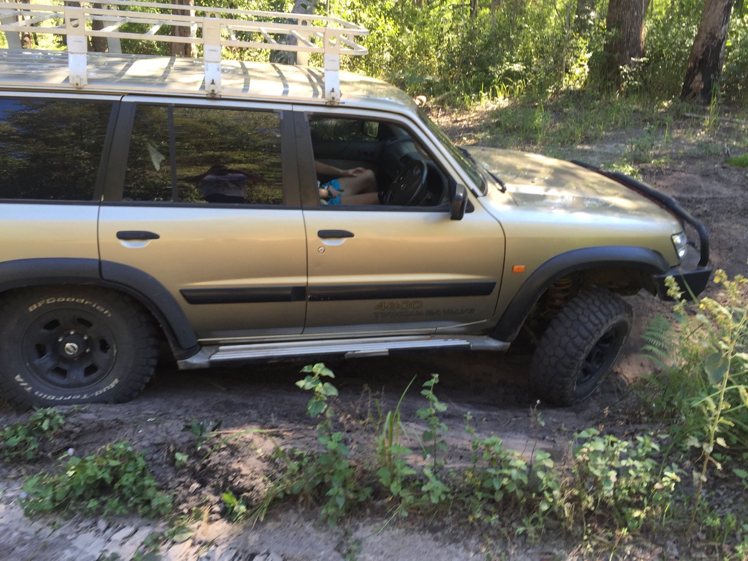

    here's mine with 285s and an EFS 50mm lift

    Thanks for the pic threedogs and the advice.
    I hope to see some pics of GUs with 3" lifts so I can compare. I guess I could always jack up the vehicle 2-3 inches higher than it is and see, that would give me a pretty good idea I guess.

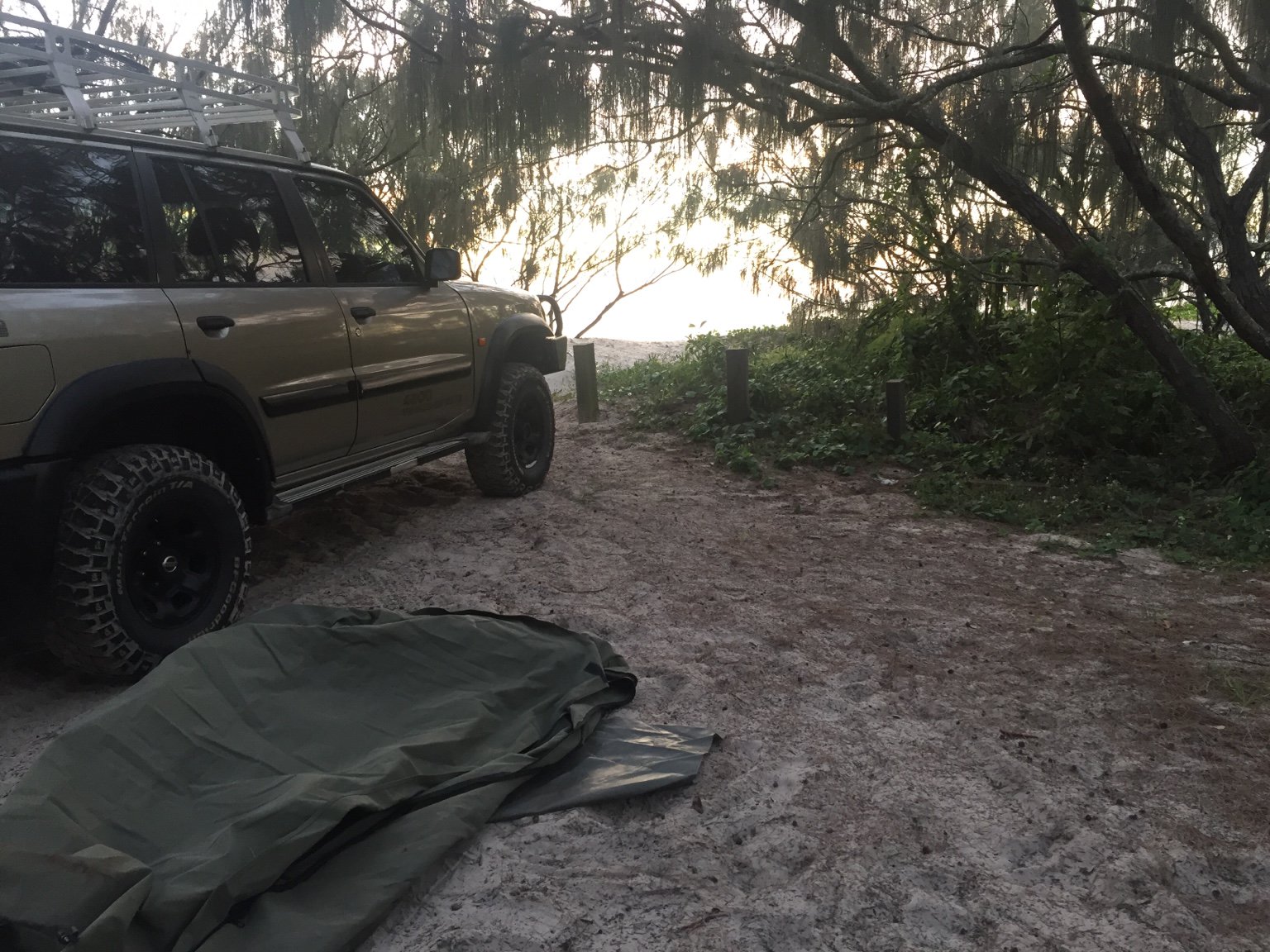

    Here's mine with a 2" and 33"s.
    Fully road legal, has decent road manners, and I drive past cops without crapping myself.
    Also, a 2" is cheaper than 3", as all you need is shocks and springs. (Potentially castor correction, but not normally needed)
    Once you hit 3" you start needing panhards, extended brake lines, etc.
    Cheers.

    Thanks for the pics Punderhead and the help from others. I'm still not sure which way I'll go???????
