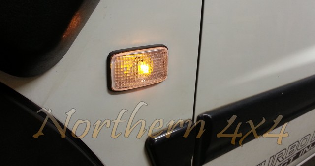

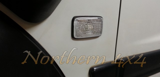

    Light on!
    Light off!

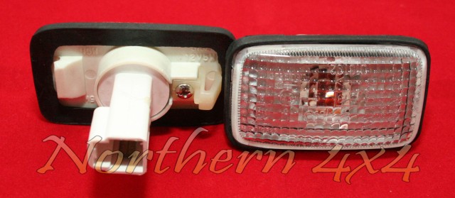

    And how you take them off is. Apply pressure on the rear section of the lamp and push toward the front of the car. They are clipped in....If you see this pic you will see what I mean. One end has a hook type thing to hold it in the guard, and the other end is a plastic spring clip. When your pushing you are pushing in that spring clip so you can un hook the light.
