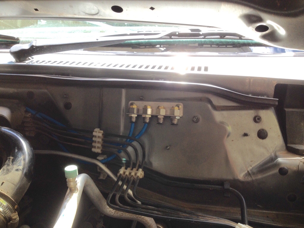

they are all good, it has the stock metal lines running up into the passenger side guard behind the snorkle
2001 GU II ST, 3.0di, Auto, All NADS done, Nissan Snorkel, 50mm Lift, 35's....
I ran my diff breathers along the chassis rail up to the engine bay fire wall...., gearbox / transfer case are still on the todo list
As others have said the rear diff factory breather is useless and terminates in the chassis cross member. Whilst The front diff and gearbox / transfer case go into he passenger side guard (3 metal tubes) - depending on your type of driving / depth of river crossings they recommend to relocate to the firewall as well

I went a cheaper option and also mounted the filters facing down so that no moisture can dribble down the tubes. I have lost a little bit of hieght, but if my rb30 has water that high, it isn't gunna run anyway![]()

Just an automotive grade rubber. I am thinking of upgrading the rear diff to chassis piece with some tougher stuff.
