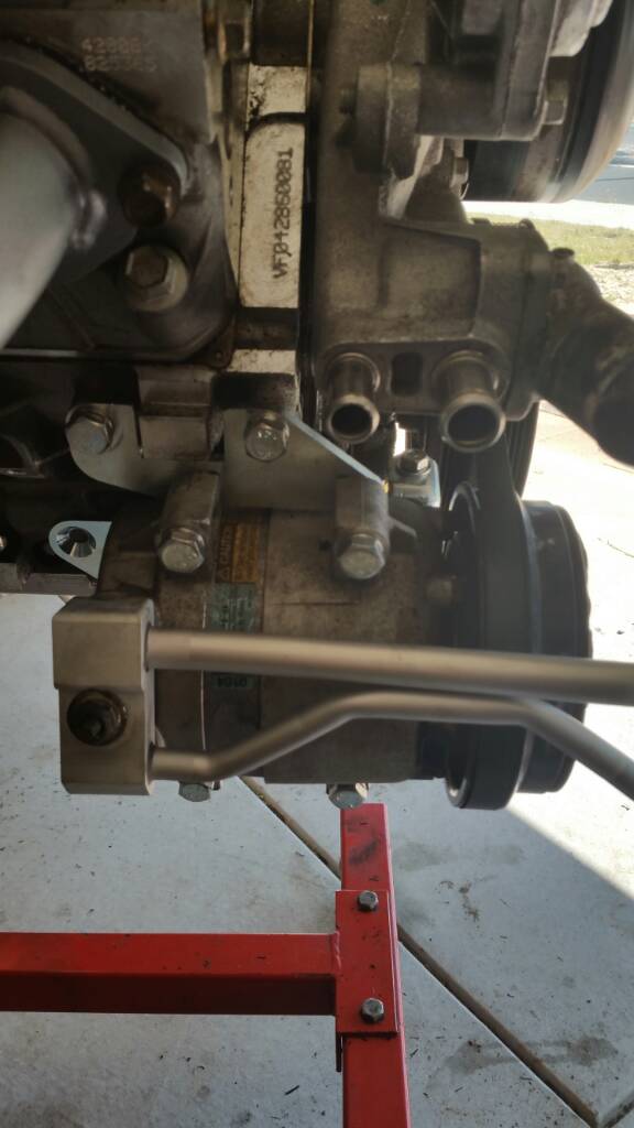

    Side shot of the aircon relocation bracketry...

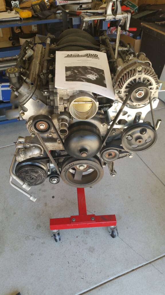

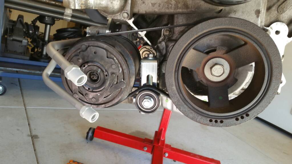

    Frnt shot of the aircon relocation setup... marks do a good bit of gear...

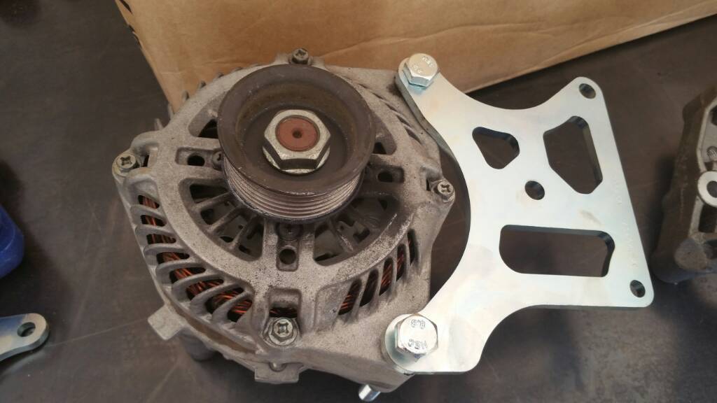

    Aircon and alternatir relocation brackets all done.. tidy n functional...

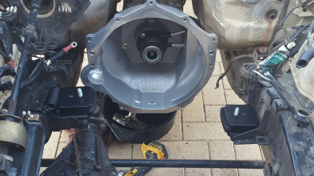

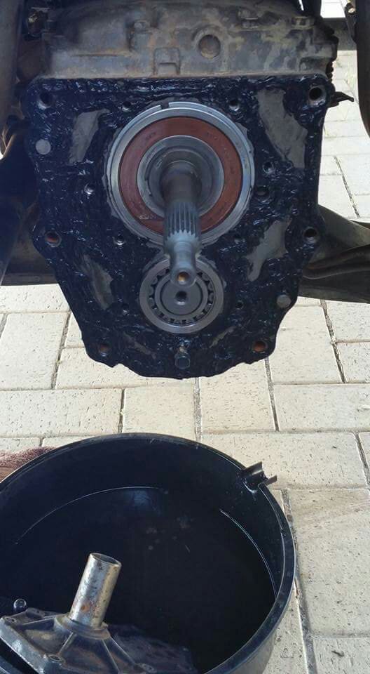

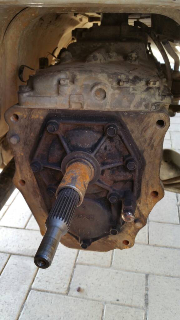

    Old bellhousing removed... such a gay job unbolting bellhousing bolts frm back of engine.. two 800mm extensions and a couply unis did the trick tho...
    Front case removed.. cleaned up surfaces with carb cleaner then new gasket sealer for a good seal between gearbox face and new bellhousing face...

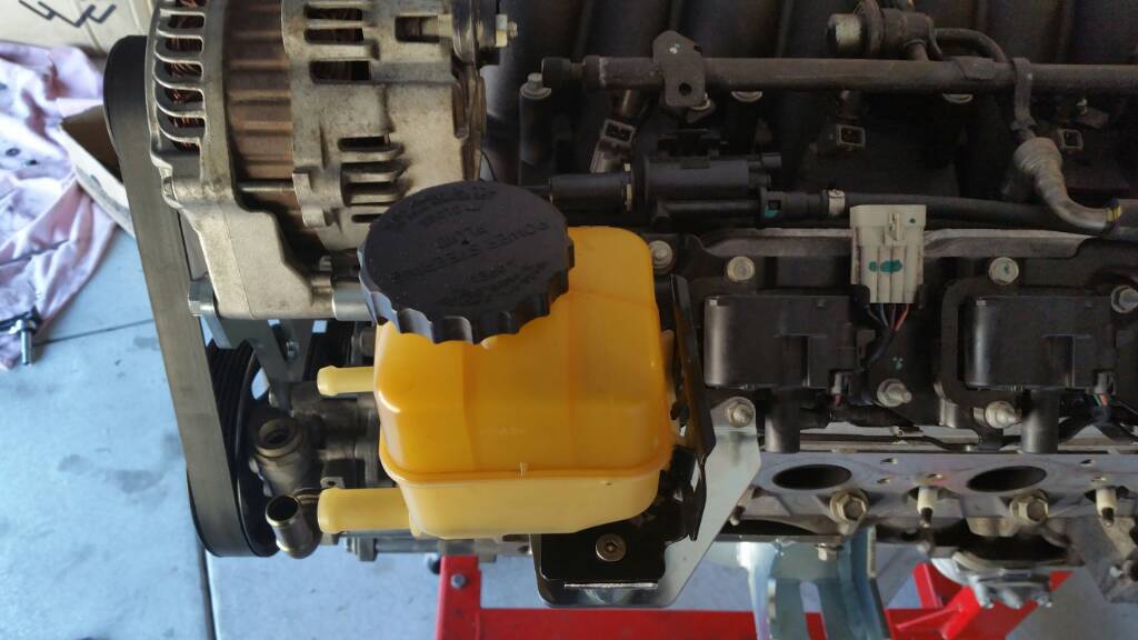

    Pic shows relocation for power steering resavoir...

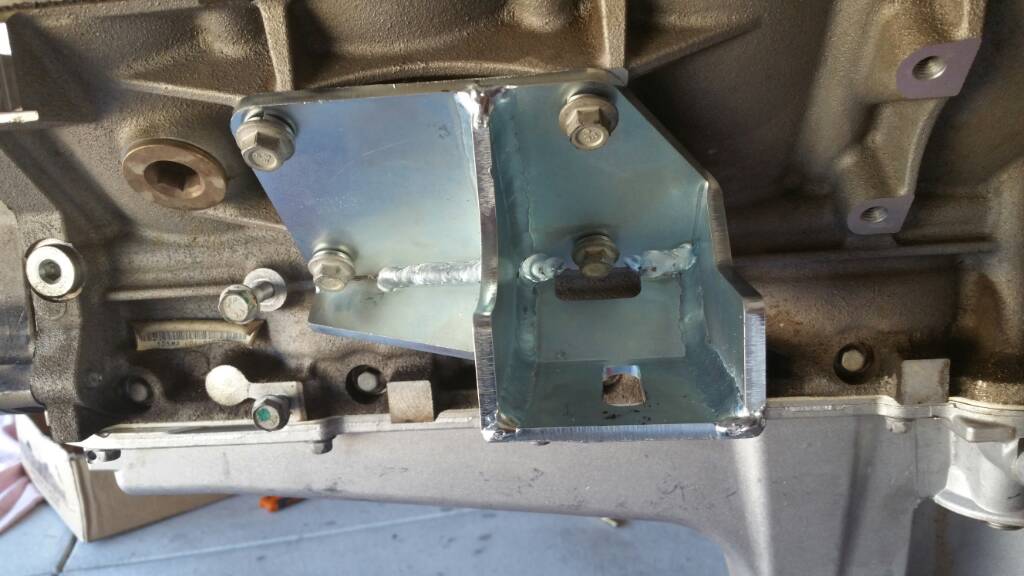

    Pic of engine mounts... nice and beefy..
