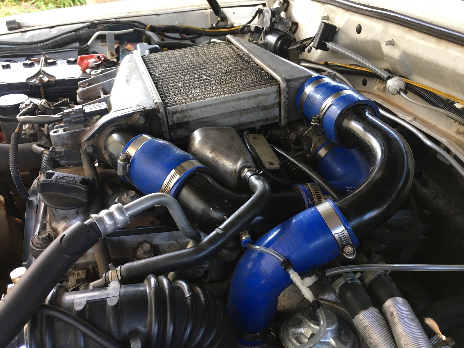

    Quote Originally Posted by ImRobboToo View Post
    I have come out of the wrong pipe, haven't i ??
    Tapping it out . . .
    Hang on. Wheres the other end of that T going too?. If you have no Dawes there should be no T. Just straight from the front ic pipe and to the gauge.
    Your ic is leaking too mate. This needs tobe fixed before you fit the dawes.

    what Mudski is saying is, you can see in the picture where the IC is / has been leaking

    31,634
    Looks like your IC is gone too, imo

    So how is this fixed ?? New IC or is it fixed with a gasket ??

    Nah you'll need a change over tig welded job, about $300 up

    So if I take the IC off, I should be able to see the cracks then ?? Might be easier to buy a new IC ... ....... This is all new to me. I will get there

    Most test by using a bike pump and a kiddies pool of water, looking at yours it will be leaking
    I think they come from the factory with leaks.ha ha
    Give it a test to confirm what we suspect, make sure its dry before you re-install it.
