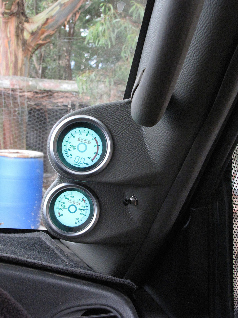

    I know everyone’s seen’em before, but you haven’t seen mine! Proof that I have managed to wire them up & get them working! I’m a bit chuffed with myself. Making that last connection to power & turning them on was a bit like starting up a rebuilt motor for the first time - you think you’ve done it all correctly, you’ve double checked, but it’s still a heart stopping moment - followed by extreme ‘chuffed-ness’ when it all comes together.
    Took it for a spin to see what sort of readings I’d get. EGT peaked out at 550 deg.C.once, but mainly stayed between 300 & 400, although it isn’t hard to get it up to 500-510 if the right boot is planted. I think the alarm may need to be raised from the 500deg.C I set it at. Maybe to 550? After a few spins ‘around the block’ it dropped back down to about 200deg.C at idle fairly quickly, I had intended to let it drop to 150 deg.C before switching off, but I reckon I’d have been there for some time, so switched off at a tad under 200.
    Max boost I saw was 9.4psi.
    Oil pressure mainly sat between 60 & 80 psi, but triggered the alarm set at 20psi when I slowed down to turn of the highway & coasted for a short distance. I re-set the alarm to 10psi. At idle it reads between 18 & 22psi.
    Coolant temp I was quite surprised at, thought it would run hotter, but it was fairly stable at around 90 deg.C & the ambient temps were fairly warm today. As expected the factory temp gauge just sat at a tad under half way as usual whilst the new gauge showed anything from 60 through to 90 when first leaving home. It confirmed that the factory gauge is, at best an indicator of only ‘OK’ & ‘Oh sh*t’.
    Not particularly impressed with the Redarc instructions for setting up, but a bit of trial & error got me through without frying anything.
    Any comments on my readings - (stock motor except for 3” exhaust) would be welcome. Also your thoughts on what changes, if any, I might expect to see in the readings following EGR blocking & a dyno tune aimed at torque & economy & long term reliability (rather than power & speed). Suggestions as to what I might ask for readings wise when taking for a tune also welcome.

    Cuppa did you have to install a temp probe into the radiator?
  8. #4646
    31,635
    Maybe a modest boost increase will help EGTs I dont think economy and your ute go together
    weighing so much, driven sedately with the van after a dyno would give you some solid touring figures
    Switches look great you'll forget they are there after a while,
    Good point on the temp gauge too , a decent after market one should be mandatory

    Dont forget that you will be towing your camper so keep that in mind when going to dyno
    maybe take the ct for a spin around the block and see what your temps are
    No, I did the same as Macca. I have a third hole on the thermostat housing alongside the factory sender units (one for the factory temp gauge & the other which is used by the glow plug timer I believe). What the purpose of the hole is I have no idea, but it has a 12mm x1.5mm thread, so like Macca I used an adaptor to take my ⅛NPT threaded sensor. http://speedflowdirect.com.au/itemdetailspage/46311 - bought mine on eBay. You can see a pic of Macca’s here - post #64.
    A good idea, I’ll do that. When you say ‘keep that in mind when going to the dyno’ & given that I’ve never been near a dyno before, are you suggesting that I just tell the tuner “this is what I plan to be doing with the vehicle” or should I be more specific & ask for specifics e.g. max EGT @ X revs?
    What are the differences in egt’s you see at say 90kph between when you are pulling your CT & when you’re not? (I realise mine will be different due to different motor & different CT, but I’m interested in what sort of variations you might see).
    I was surprised that the EGT’s didn’t seem especially rev related, but rather were more ‘work’ related. e.g. went higher when pulling up hill in a high gear, reducing if I changed down.
    Yet on the flat I could be cruising along at 110 with only 350deg showing. I was also surprised at how quickly the egt’s could rise & fall. Need more time to suss out the relationship between boost & egt’s.

    Tell the tuner what you plan to do.
