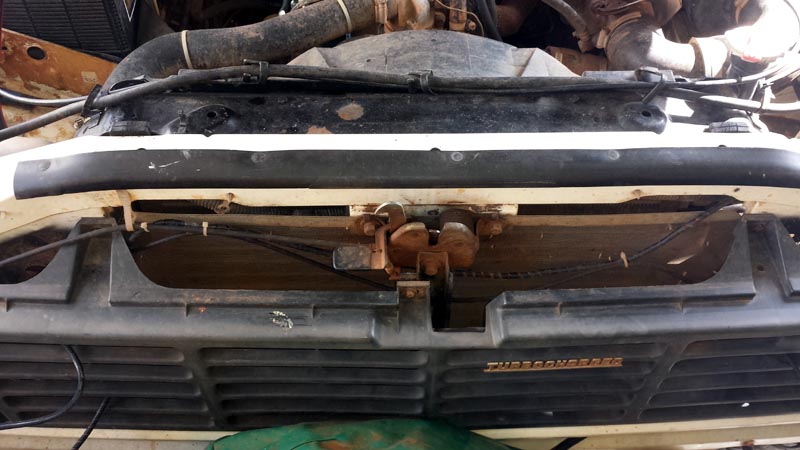

    Grass seeds in the radiator!
    Just wondering what everyone does to a) clean the grass seeds and bugs and crap out of the radiator and b) prevent them getting in their in the first place?
    I have seen some 4wd's getting around with shade-cloth zip-tied to the bullbar, or cut to size and fixed to the front grille. Is this the answer or does that cause possible overheating due to lack of airflow. Then again, it can't be worse than the effects of a radiator full of grass seeds...

    Thanks guys, I have hosed the crap out of it from the inside and also used compressed air. I think I got most of it and a lot seems to have come up from the underside more so than straight through the front grille, which is to be expected I suppose.
    At this stage, I am leaning towards the zip-tie method with some coarse shade cloth (as I have some handy) and only putting it on when needed.
    I'll pull the radiator next year before a big trip as part of a preventative maintenance plan and give it all a thorough clean.
