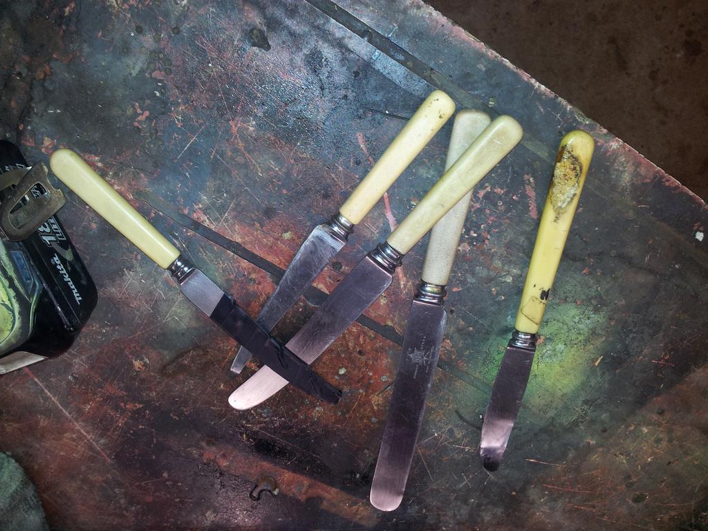

    Mate you know whats better than that? Bread and butter knifes , the old school ones. I use them for pulling interiors apart, lcd screens . Another trick for removing winding window hands is to fold your shirt in half slide it under the handle and pull it side to side.
