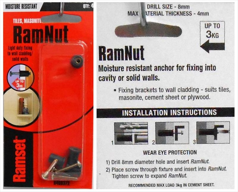

    It is a real pain trying to get the ball socket installed into the little cubby hole, you need girlie hands and a bit of patience. WARNING, there are bits of "car" immediately behind the cubby hole, drill carefully and shallow, I used a drill bit with a lot of tape a few mil from the tip to avoid going too deep. I drilled one hole at a time, using the base plate as a template for the next hole.

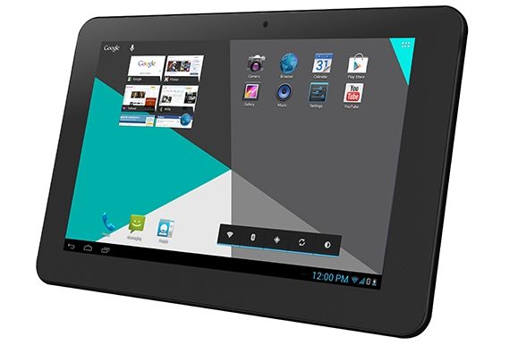

    Tablet and holder attached
    Looking good
    A quick trip to the shops and all was good, no vibration and the Tablet screen was easily read. It is a bright sunny day here today so I was a little surprised about how well the screen display read.
    I have both street and Ozi Android navigation Apps installed.
