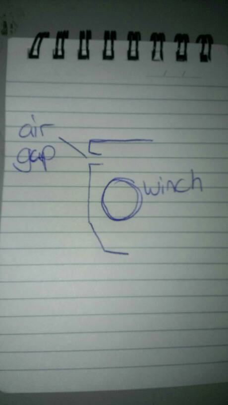

    Which joint are you saying to use ??
    Attachment 26821
    Finishing off the project is easy i have flap discs, grinding and cutting discs and a few different die grinding dremals (stone and steel) its just the fine technical details are what puzzle me ATM.[/QUOTE]
    No.1 mate. Lots of tacks on the inside, full weld the outside, but stagger the welds...
