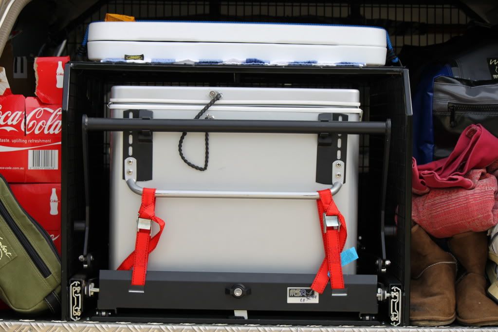

    The latest project has been the air box and the cage for the fridge.
    The cage i have used 12.7mm rhs for the frame and mesh to fill it in. the bottom rails are 65 mm flat and that is how it bolts onto the slide.
    Top rails and mesh are this weekends job
    flat bolted to slide
    showing the 2 side pieces

    Nice work on the cage for the fridge, I had a similar set up in a wagon from the other stable, its really supprising how much crap falls in behind the fridge . just a quick one on the intercooler, how did you go with mounting all the other factory coolers etc when finished, Im thinking of going front mount as well and am looking for ideas on fabrication for brackets etc, a pic would be nice if you have one

    Ink bandit I'll look around for aphoristic for you. As for the coolers, we used a smaller rectangle cooler (the old man had one handy in the shed) my hubby custom made a frame to mount the intercooler and was made to keep the bonnet latch. And we just got rid of the thermo fan for up front. Haven't had any problems with heating. We are towing a comp truck to bris this weekend and on our test run temps were sitting good.
    Having the cage just makes it easier to pack and makes it possible to pull the fridge out haha.

    Fridge cage done and all loaded up
    Bit of flex
