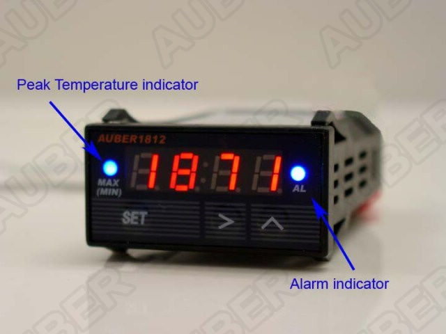

    I have just received my pyro in the mail so that will be going in soon. I bought one of these.

    Few small updates to add, firstly I got around to installing the pyro gauge, pretty happy with the unit, I ordered one with amber display to match the mavericks original gauges, also hooked it up to the light circuit so it dims when the lights are on. I can even set up an alarm if I want and have a buzzer hooked up to the alarm. At the moment I haven't screwed it down or anything but it seems fairly secure so I will see how it goes.
    And here's the probe, its only 3mm in diameter and seems to react very quickly to temperature change. Very happy so far.
