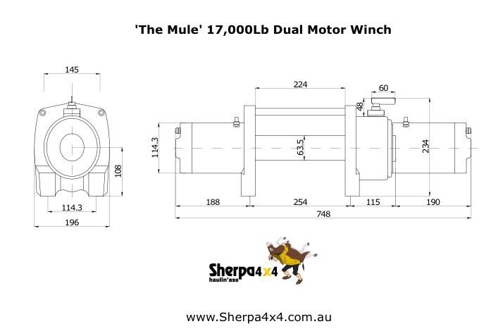

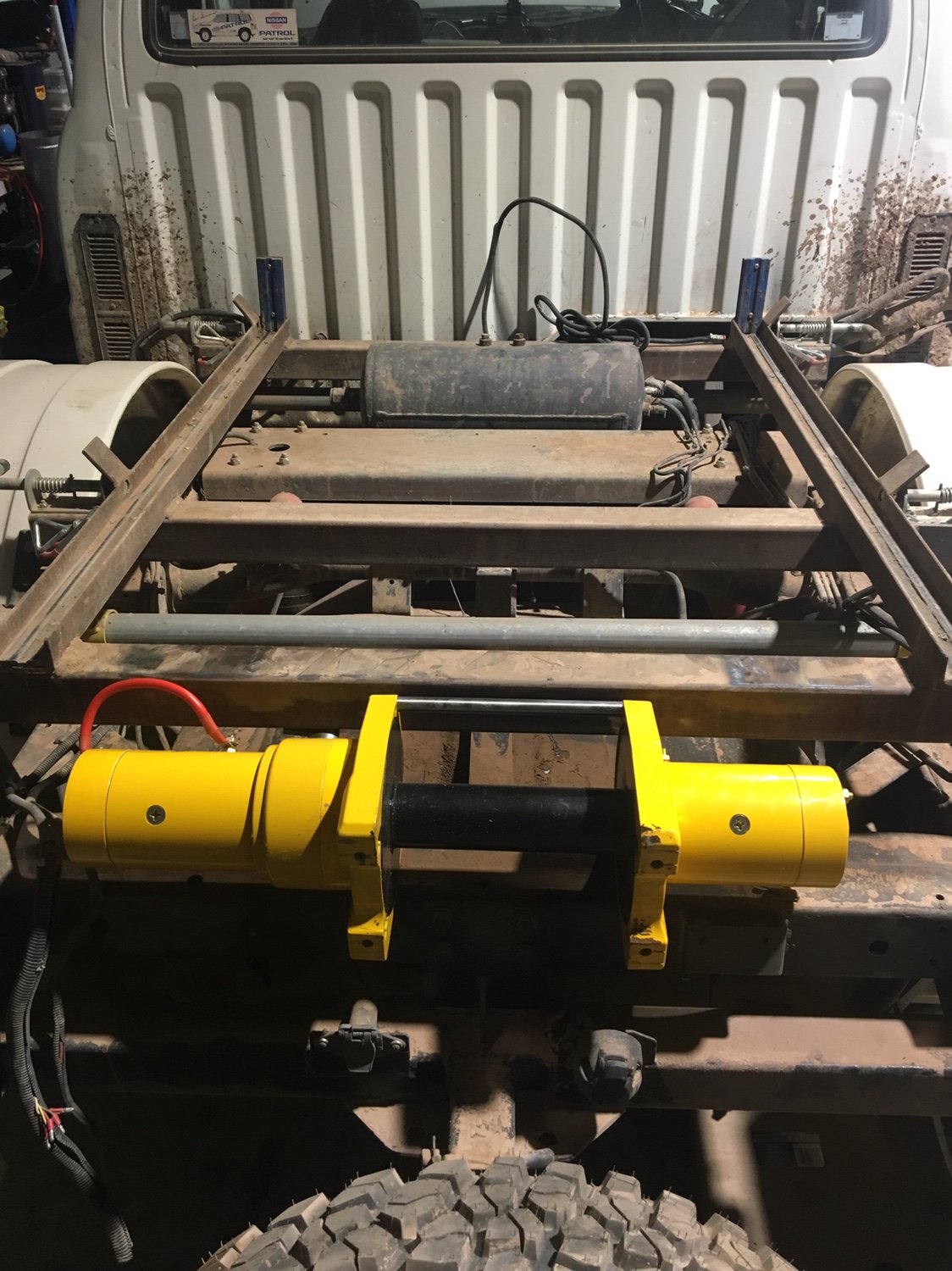

Sadly another busy year has gone by, shed queen is still awaiting TLC including previously planned add ons as per the 17,000lb Mule for its rear purchased above.
Family fun adventures in the old faithful GU wagon are taking first place of late and wondering whether or not the Mule could assist hauling our barge?
http://www.nissanpatrol.com.au/forum...2019/11/38.jpg
Our wagons current old faithful Warn 9,000lb low mount I seriously doubt will handle an upcoming planned adventure and looking towards getting the twin motor Mule up under there.
Measurements today find it could easily fit width wise albeit needs the mounting holes and fairlead shifted left some 20-25mm.
