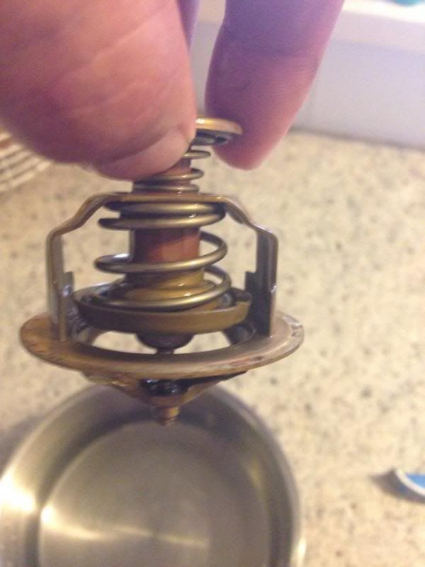

Now how or why isnt the fan working? its brand new. How can you test the fans functioning? Considering going twin thermo fans now so i have control of when they come on. Also going to scrap the standard rad in favour of a pwr unit $1275 delivered. Will look at replacing thermostat again as well.
