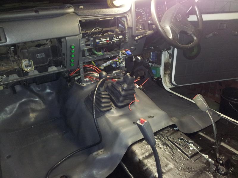

I've been quite last few days this is why. I still have a mountain of work ahead to conduct separate everything.

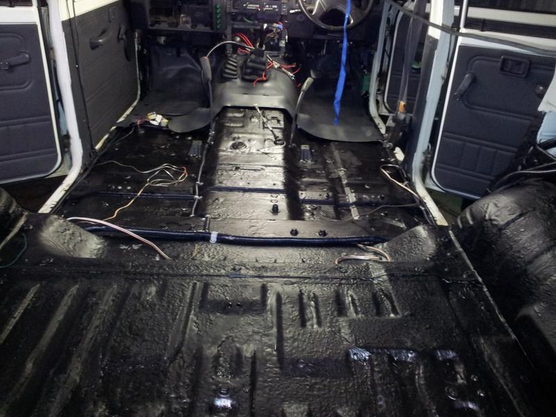

While its apart like that mate go and buy a 4lt tin of brush on Sound deadener and give the floor 3 or 4 coats and also the inside of the door skins. You will thank yourself.

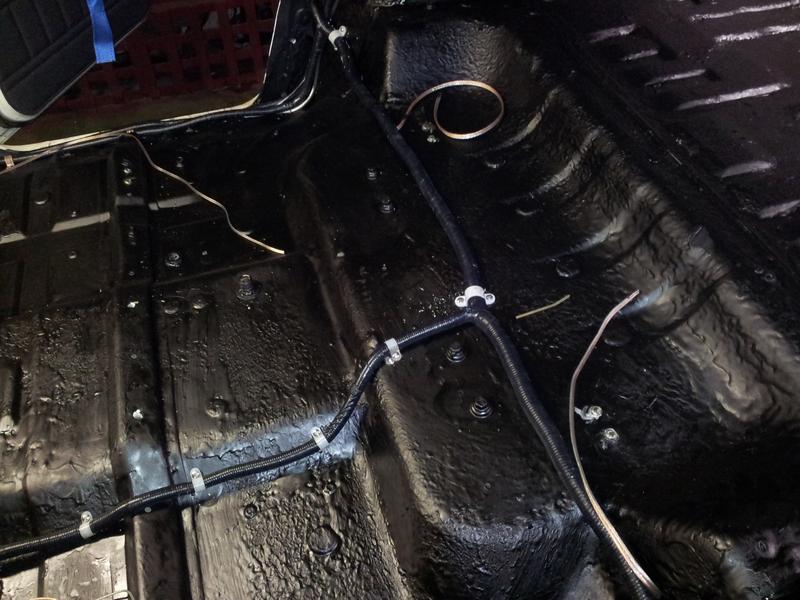

Also think about buying a heap of different coloured heat shrink and colour code both ends of everything so you don't have to rely on labels that might not be readable in 5 years. A band of heat shrink 40mm long on both ends of each wire or a few wraps of electrical tape on each end will be a winner mate.

Cheers mate, I've allowed cable for everything. I know it looks like a mess atm .
Central locking,
Amps
Sub
6x9's
fridges
12volt sockets
worklights 4 allowed for rear.
4 switches back to cabin.

I would hate to think how much money I've spent on cable not to mention switches/relays/fuses boxes so on so forth.
Probably up to about 40-50 hours, coming together tho. Rear seats wont be going back in, full length draws with a cargo barrier. Seal and sound proof the floor .

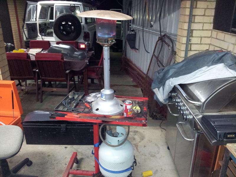

Takes lot of time but it was worth it.

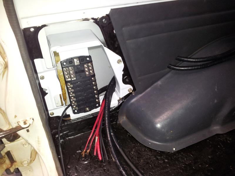

The amount of wiring I've added is insane.

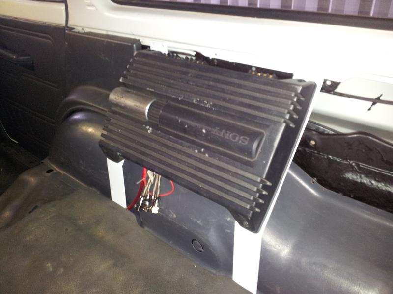

Great job like the sound deadener, my last 4x4 had internal roll cage so I mounted the amp and 2 6x9 4ways in the roof
Once I run my draws full length the amp will sit in cavity with lift out lid. Thats why i have angled the fuse box the way I have. 6x9's will go behind the front seats in draw system. I'm itching to get started on draws and cargo barrier. Steel skeleton, sheet metal draws and mdf/carpet top. From what i have planned should take bout 4 weeks to make weekends/after hours.

Big differense with the paint noise killer?
I was not really chasing the sound deadening affect, more the sealing the floor was the point of the exercise. Once my draw sets go thru I don't want to have to be worrying about the floor after everything is in.

Mate I was wondering what body deadener did you use and how many coats and what was the drying time.

Well first stage is complete now I can start building a 4wd now that the ground work is in. Its taken me a few months to run all the cable properly but I have one hell of a base electrical system , next stage solar/third battery/inverter.
