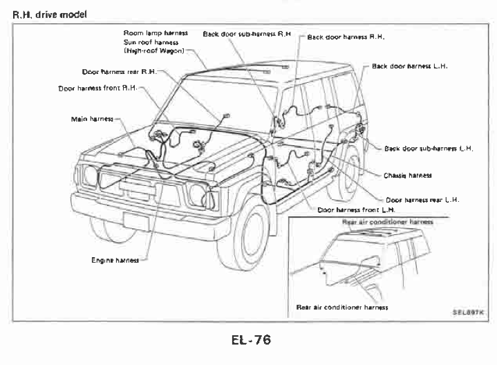

Yep its the junction plug for the front and rear looms
http://nissanpatrol.com.au/images/St...LoomLayout.png
Hey Growler, sorry mate just read your original post again. looking at the pic with the fuse holder and the pic you posted later with the cover off it appears that that wire does not go through the floor.
I reckon its a lazy mans way of getting a fuse into a circuit. I think you will find they ran the Twin core and used both sides as Positive for the fuse run alone. As Yendor said Definitely Aftermarket.
Before you go putting a fuse in that just trace it back to where it goes mate, You will find that one will probably go to the battery an wherever the sheath finishes the other side will split off and go to whatever it was going to power up. Maybe a floater in the engine bay!!! Should be really simple to trace though mate.
rethought it could be Nissan's original idea for cat converter temp sensor this is where my gtr connects up
Nah it just cant be factory! the rest of the wiring in that pic is the factory Loom! if that was from the factory it would be wrapped in the loom with the rest. Definitely junk. In the second pic that was posted by Growler you can see the loose wire running along the sill above the loom! No Way its factory.
