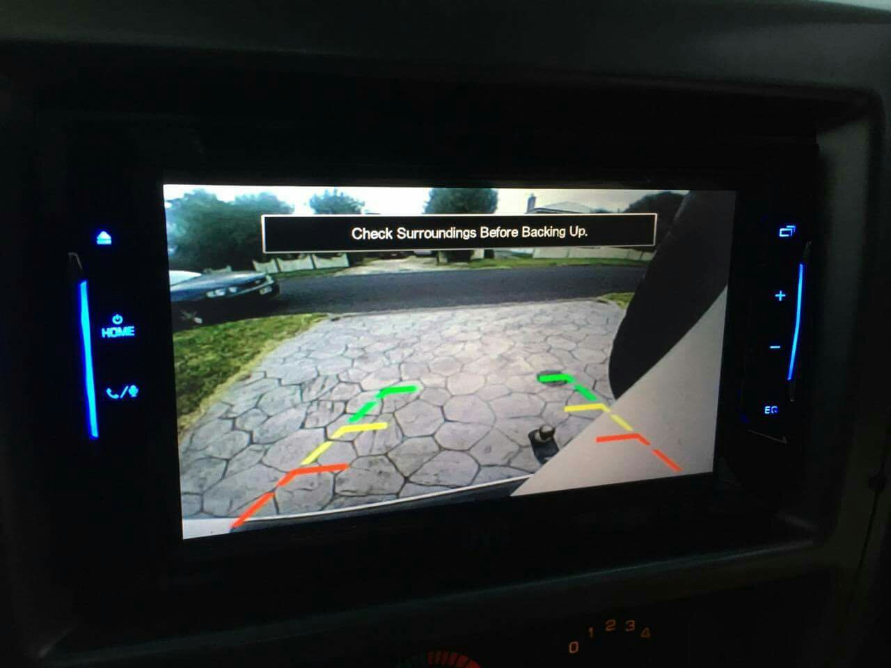

Have installed reverse camera.
Hooked up the dimmer on the head unit.
Still need to sort the park brake hack so dvds work.

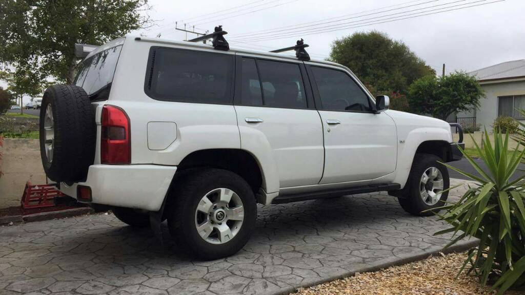

Finally finished the lift..
Love it..
Well.. need to sort front towers..
Resealed the light bar.
Tightened front wheel bearings.

Dont you just earth the park brake circuit out? Then dvds will work all the time. The hand brake switch is just a simple normally closed switch.

Well my DVD issue was the wrong wire..
Found the manual.
Then found the wire tagged park switch..... 😐
Earthed it out and wholla.. DVD works..
So now it's all up and working as it should..
