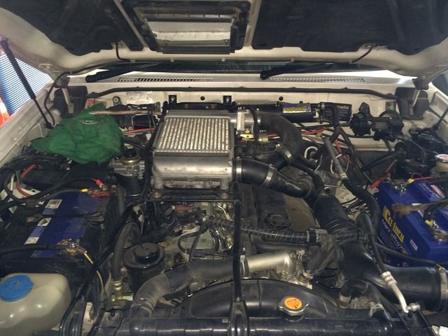

It then came time to fire this thing up, I've had the battery on charge the other day, so it's good to go. Double checked and tripple checked under the bonnet for tools, along the sides of the guards, on top of the grill, bull bar, everywhere. Then went back to the tools and put them all in the tray, none missing, great so time to hit the key. Before doing so I removed the plug on the fuel cut solenoid and then proceeded to crank it over, gave it 4 hits of about 4-5 seconds each to pump some oil up into the turbo. Reconnected the fuel cut solenoid, hit the starter and it burst into life almost instantly, and idled away so soothly and quiet, it's never been so smooth and quiet since I've owned it. I was much relieved.
I let it idle for a few minutes and scoured over it with my trusty work lamp looking for leaks, flapping bits, anything that shouldn't be there and to my discust noticed an oil leak on the oil feed fitting to the turbo where it comes from the block. So shut it down and went about fixing it. Well this fitting is a piece of piss to get at when there's nothing there, but after the turbo, intake pipe, battery, etc. goes in you can see it, but touching it is a challenge. Anyway, about an hour later, the fitting was out and reinstalled with a new copper washer behind it, test again and all good.
Went for a small drive, stopped about 1 km up the road and rechecked everything, all good. Noticed the pyro gauge was not working, get home and check the power supply, no power. Closed the door and a job for tommorrow, as by now it ws 1:30 in the morning.
Next morning, sus out the pyro, pull it all out and find a wire labled "pyro power supply" taped up under the dash not connected to anything. Guess that was me last time doing half a job. Anyway, used the opportunity to run an ignition power source into the cab and into a 4 way fuse block, so now I have 4 pre-made ignition sources. Wired it all up, tested Ok and went for another spin. Eventually the pyro starts working, driving around on a light throttle I see 150 - 250 deg.

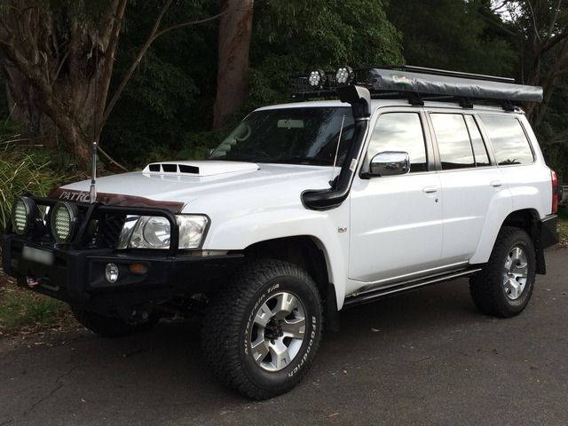

Pulled up at a mates house for a beer and a quick photo.

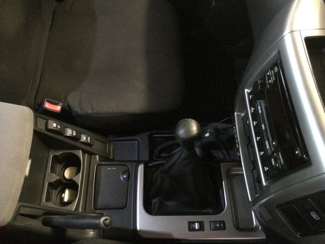

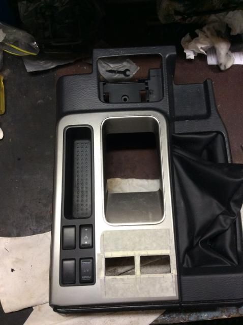

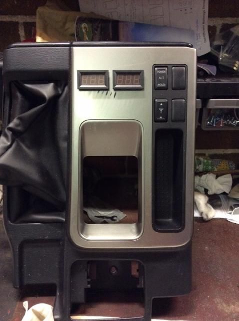

Update from the weekend. Bit of a relief to have it running again, so decided to tackle a few other jobs that need sorting out. Started out by installing a couple of 8 B&S power supplies to the 12 pin plug for the caravan fridge and the Anderson plug for charging van batteries. These were run through relays and triggered by an ignition source so they are only active when the ignition is on.
Then I installed my Redarc Tow Pro trailer brake controller. I put it in the blank on the right hand side on the gauge light dimmer. Came up pretty good I think.

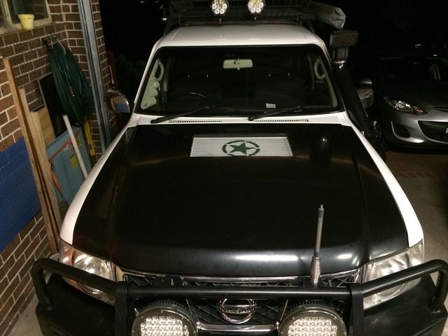

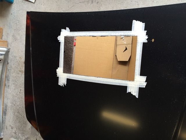

So then on the Sunday I set about righting a pretty embarrassing wrong from the other week. Started off by removing the bonnet and placing it to the side, out of bloody sight!!
http://i1083.photobucket.com/albums/...psea6ixuac.jpg

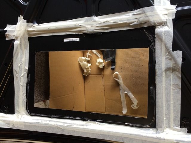

Placed the "other" bonnet on and marked out the position of the intercoooler. Removed it and placed it on a couple of stands.
http://i1083.photobucket.com/albums/...pstnpplxv2.jpg
Then set about cutting a new hole straight through the middle of it, this time in a more appropriate location and size.
http://i1083.photobucket.com/albums/...psodhn57jw.jpg

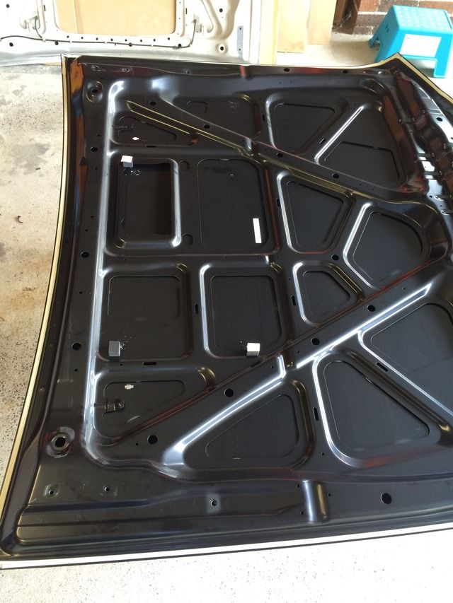

Turned it over and removed some of the bracing next to the hole to allow the cooler to seal up neatly on the bonnet.
http://i1083.photobucket.com/albums/...psl8jlravv.jpg

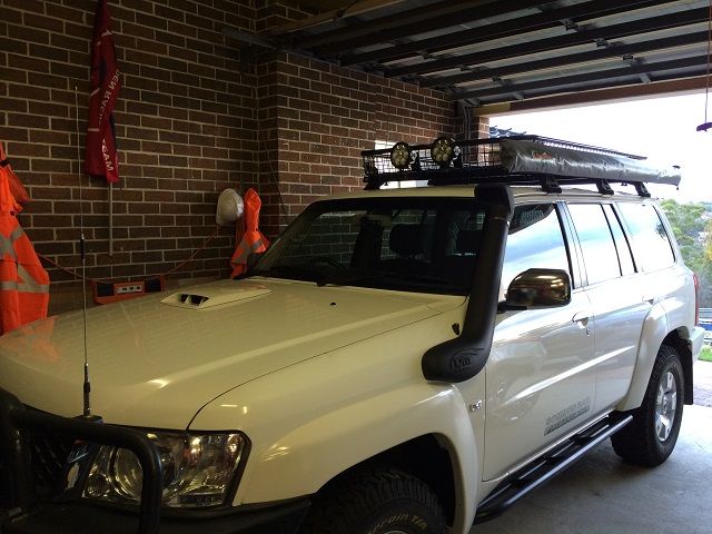

Put the template on the bonnet and set the back of the scoop 12mm from the back of the bonnet after receiving advice from Bob at Fairline, he's a super bloke. This means that only a couple of the bolt holes land in awkward locations. Drilled out all the holes, opened up those in the bracing with a step drill and then painted all the fresh edges. I'll sit the bonnet back on during the week or next weekend, haven't decided yet. It kinda looks pretty cool with a black bonnet, I'll get some pics after.

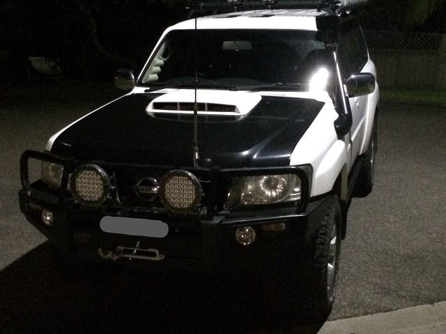

Better put the black bonnet photos here first :p
Haha, I'll see what it looks like. Will paint it white and then might wrap it in ricer carbon fibre :rolleyes:

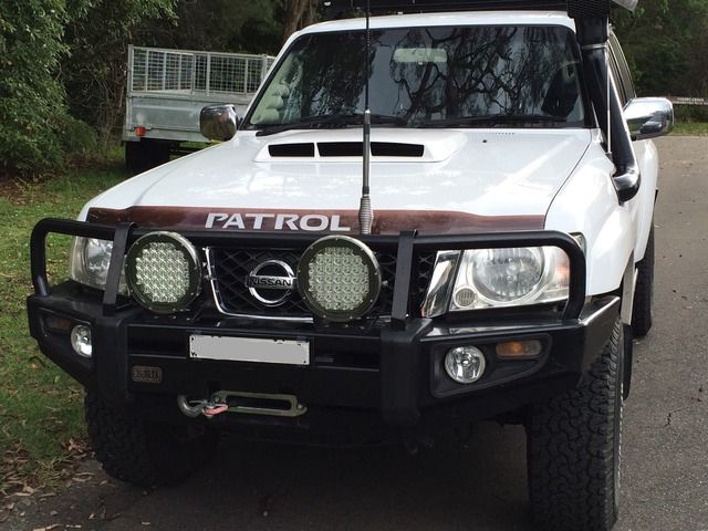

Hey Rod. Can you get some good close'ish shots of the snorkel. Where you've cut into the guard. I'm in two minds wether to do the same as you or to go the other way. Where I don't cut the guard...
Cheers.
Just cut the guard, what could possibly go wrong ....
I'll get some pics tomorrow Mark. If I get home in time I'll try and get some pics in the day light, always better than a flash.
No rush mate. Whenever your walking past with a camera in ya hand.
Its not the cutting im concerned about.
Its the look of the large hole. I dont know if i like that or not.
You know you want to Just do it ive got a length of pipe here
if you need some 60 will do it
Ok. Where do you live again. The offers there Eric. Lets go for a drive one weekend.
God's country mate, just keep drive towards the sunshine and if you end up in Shitney you've gone too far :D

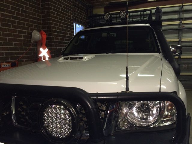

Needed to use the wagon tomorrow so I threw the bonnet and scoop back on tonight. I put one of those foot stools on the radiator support panel being careful not to squash anything to important, this allowed me with the help of an apprentice (aka my wife) to lift the bonnet into position. I could then release my apprentice thus keeping in favour with my apprentice and complete the bonnet install by myself. I used a piece of pool pipe to support the bonnet until I could get the struts back on.
http://i1083.photobucket.com/albums/...psrwkagkyt.jpg
http://i1083.photobucket.com/albums/...psnf8m3eof.jpg
http://i1083.photobucket.com/albums/...psh18bycve.jpg
Dressed the bonnet with some windscreen washer nozzles, tubing, rubber stoppers and the weather strip, then set about bolting the scoop back on. Came up pretty good.
http://i1083.photobucket.com/albums/...psejyc5zas.jpg
http://i1083.photobucket.com/albums/...psijjtn2ca.jpg
Still not convinced on the black bonnet, but I'll see how I go with it over the next couple of weeks, it might grow on me.
While I was going I installed a set of LED front Parker globes I picked up a while ago and while I was under there I spotted an oil leak which was traced back to the front steering dampener. Seems the weld around the end of the dampener has split. Possibly due to the body of the shock hitting the bars and the eye getting yanked around a bit further, either way it's buggered and depositing oil on the front bars and diff. Time for a new one.
Am I better off keeping the eye to eye set up or going to a pin to pin arrangement?
Rod, don't let it grow on you, it looks awful!
Nothing nicer than an all-white Patrol. If I were you, I'd even colour code the bumper.
Wish mine was white..
To be honest I hate the look of the bonnet, it will be painted as soon as possible. It's not really a black either, it's just the colour new panels come it.

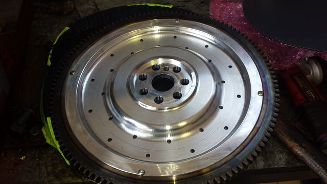

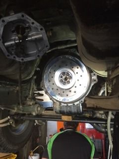

One of the final pieces of the puzzle went in yesterday. Pretty stoked about that. The flywheel arrived at my mechanics and they opened the box to find this:
http://i1083.photobucket.com/albums/...ps7gvxnmya.jpg
http://i1083.photobucket.com/albums/...psq75nxlbk.jpg
http://i1083.photobucket.com/albums/...psju2pb6sx.jpg
They guys were very impressed with what they found and took a heap of pics, commenting that it was the most impressive flywheel they had seen and appreciated the amount of work and machining that was involved in making it. Nice work and a big complement to Boosted6 and his suppliers.

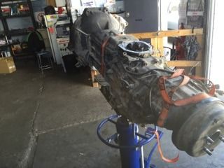

So it was up on the hoist and out with the old
http://i1083.photobucket.com/albums/...psalowhpyl.jpg
http://i1083.photobucket.com/albums/...pswdysmpu1.jpg
http://i1083.photobucket.com/albums/...psw4najktd.jpg
And in with the new.
http://i1083.photobucket.com/albums/...ps6iu2v540.jpg
To this they boltedd up a UFI clutch, replaced the rear main seal and also changed the 2 uni joints in the rear prop shaft.
They then commented on how nice the clutch felt straight out of the box, standard weight and feel and super smooth. To say the least, they were mighty impressed with the final setup. Looks like all the research has paid off.

So what the flywheel cost if you don't mind me asking? And who is it from?
PM sent...
