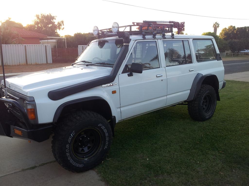

Also with the new front bar on. Swapped my bar for identical bar even same colour very happy this ones to suit 2" bodylift just got to trade my rear bar for another 2" lifted one or sliders.

So I picked up a brand new mudstar 35" last night on a rim for a slab of cold ones. Im stoked ive just fitted my mudzillas flares and bodylift for the absolute cost of wait for it $0 thats right cant beat that price loving the monster at the moment.
