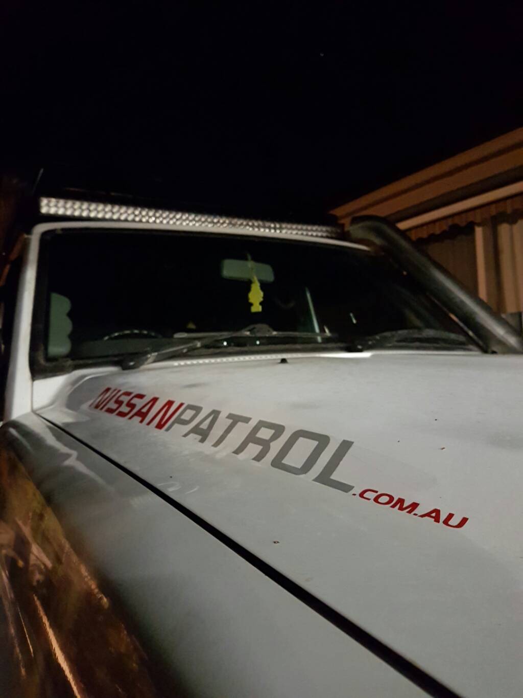

Mounted up the roof top light bar. Now the fun job of wiring it in..
http://www.nissanpatrol.com.au/forum...016/05/113.jpg

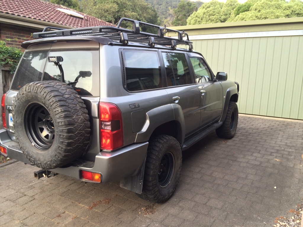

Put the mud tyres on ready for next weekends high country trip!
http://www.nissanpatrol.com.au/forum...016/05/126.jpg
