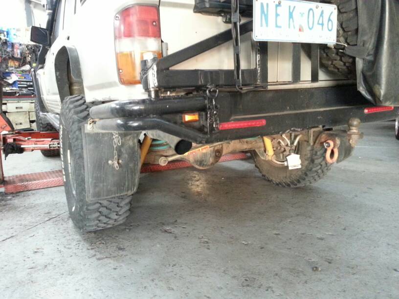

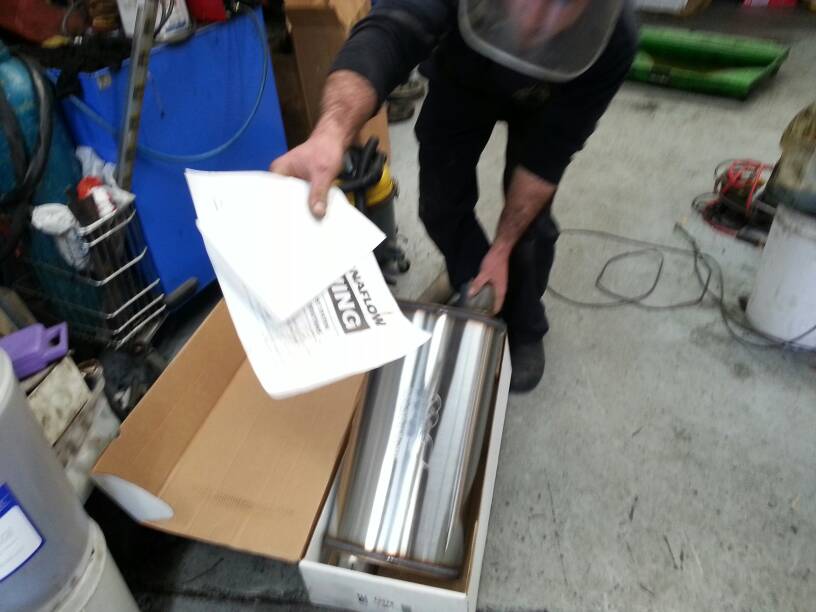

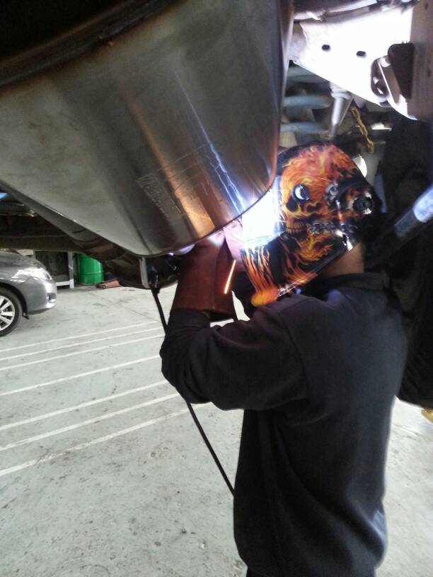

Bruce got muzzled today... in went a high flow muffler from the states to make those long trip easier on the brain.
Also mudski supplied some goodies including the larger vacuum canister and a new cap for my power steering.. happy days.
So many will be disappointed that5 bruce no longer makes fully sick noises and does not sound as tough but these long trips were killing me.

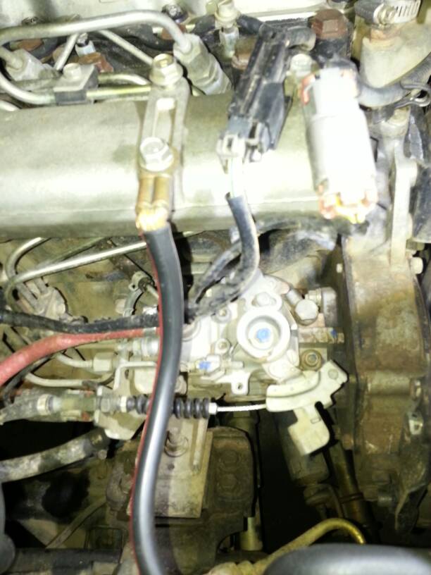

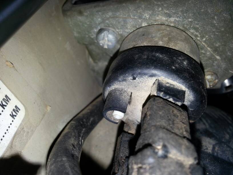

Also fitted the idle up but cannot figure where the vacuum hose goes to out the back of the unit??
http://www.nissanpatrol.com.au/forum...015/08/306.jpg
The vac hose goes around to the vacuum tanks via a solenoid valve. There will be a small port, probably with a rubber cap on it on the steel tube setup at the tanks. Thats how it is on mine anyway. But have been told to not bother with it. Dunno.
Nice one jono. Mine doesn't have idle up and works fine, being a torquey td doesn't really bother it. Seeing as yours is close may as well get it going I spose. . .
Confusing as from what have seen it goes to the injector pump???
Yeah I'm at a loss.... Mat or Bene will jump in soon and tell ya.
I dont seem to have the same i/pump setup as from what have seen the hose went to a diaphragm but i dont seem to have one.http://www.nissanpatrol.com.au/forum...015/08/307.jpg
It goes well and does the job STOP stressing
Im not stressing.......?
Your just a worry wart LOL
You are missing the bracket and diaphragm arrangement. I wouldnt worry about it to much. Just set the idle a touch higher to compensate.
