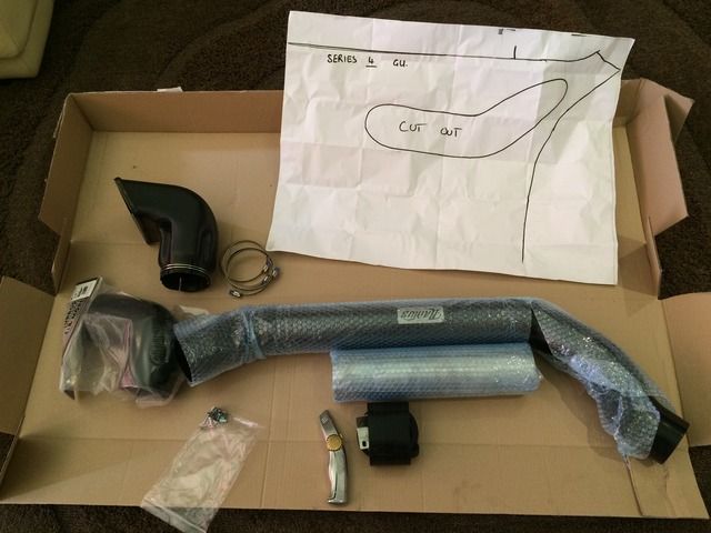

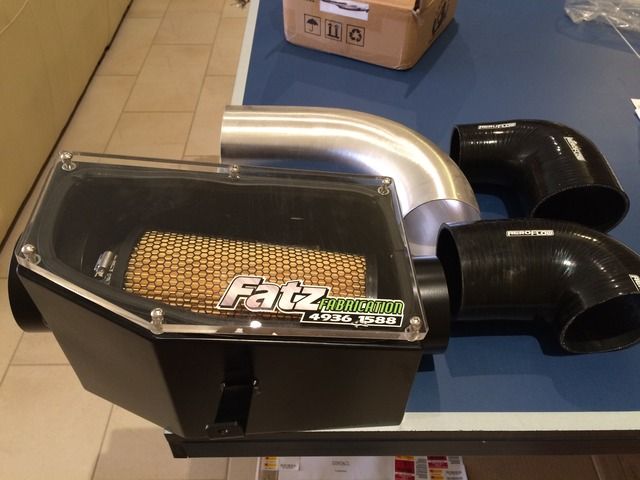

Apparently the airbox fits without needing to move anything and will fit with a second battery in the standard position under the bonnet. Hope they're right. If I have to move stuff then I should have got the Radius panel filter box instead as I think its a bit better setup, but requires the battery, header tank and vacuum canisters to be relocated.
Theory goes that the freer the intake is, the more responsive it is and torque it generates. time will tell I guess.
