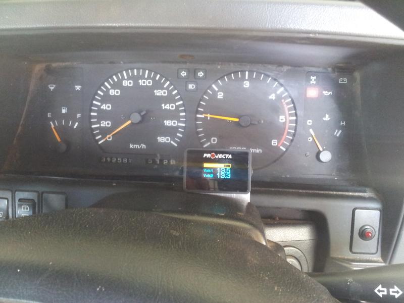

I'm always keeping an eye on my battery's. The compressors I am running are big and these two together are as good as my belt driven one in my workshop.

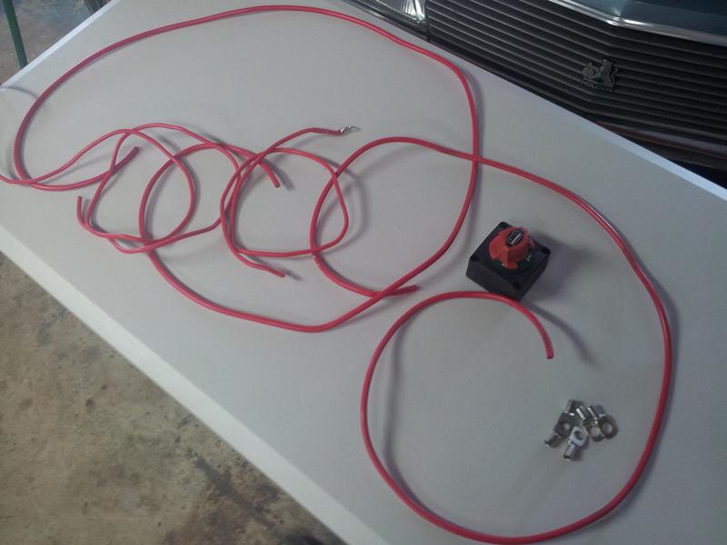

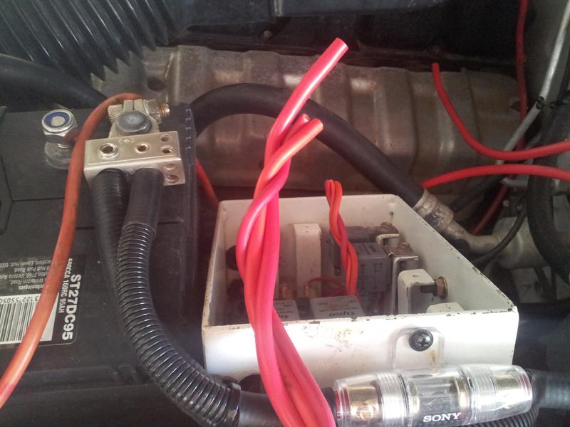

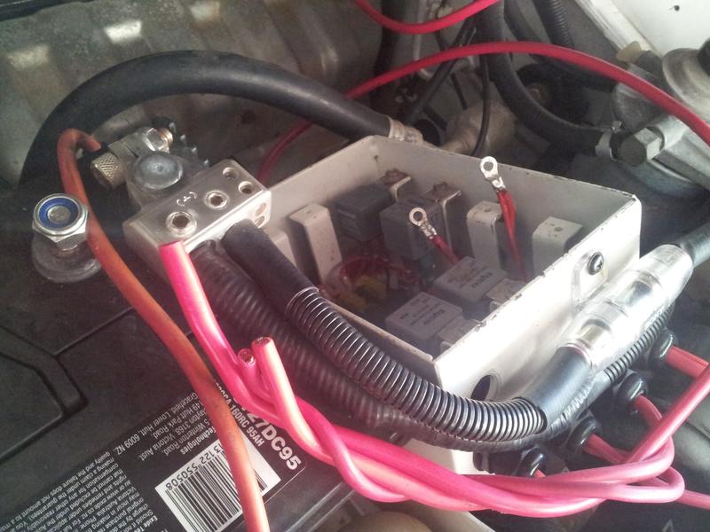

Re-wire begins,
http://www.nissanpatrol.com.au/forum...2013/11/79.jpg
I solider heat shrink everything,
http://www.nissanpatrol.com.au/forum...2013/11/80.jpg

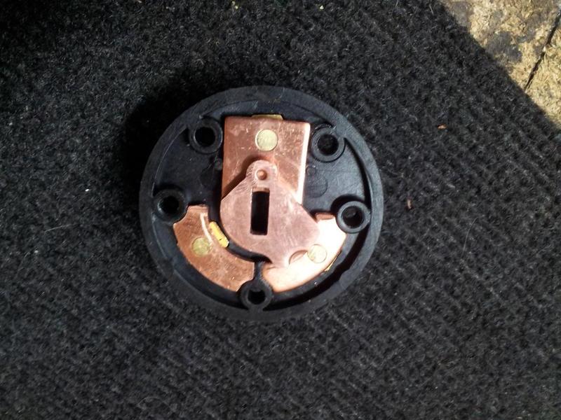

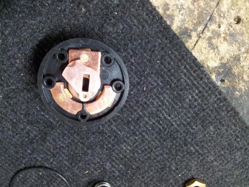

I should have seen this, I cant do it this way because it physically will join the wiring for both batteries . I would love some input here, the only way I can see out of this is if I go ahead and add the third battery now.

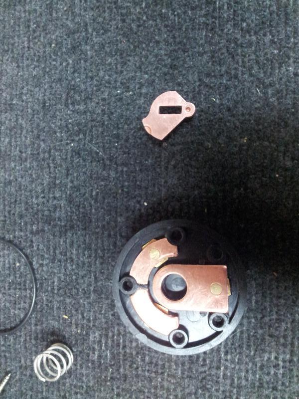

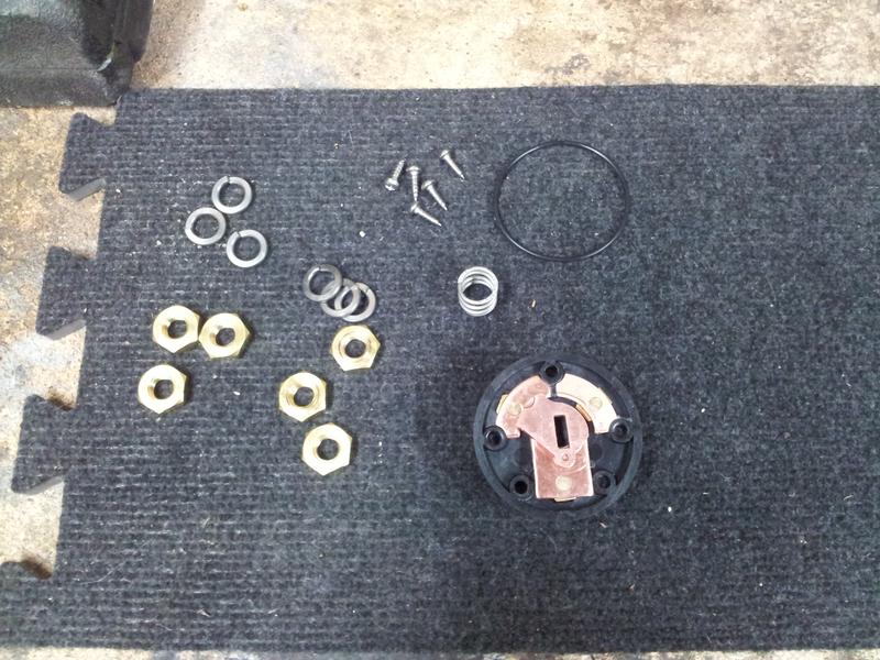

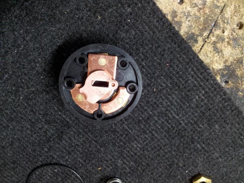

Not sure who is following but after some thought I pulled the Dual battery switch/isolator apart and worked out the contact points and filed down the part where the switch makes contact joining the batterys.
http://www.nissanpatrol.com.au/forum...2013/11/89.jpg
http://www.nissanpatrol.com.au/forum...2013/11/90.jpg
http://www.nissanpatrol.com.au/forum...2013/11/91.jpg
http://www.nissanpatrol.com.au/forum...2013/11/92.jpg
http://www.nissanpatrol.com.au/forum...2013/11/93.jpg
So from the Common it only able to select ether source 1 or 2 no 1+2.
You do know you can buy them like that? Mines 1 , 2, 1+2 and off and was under 30$ rated 150 amp
