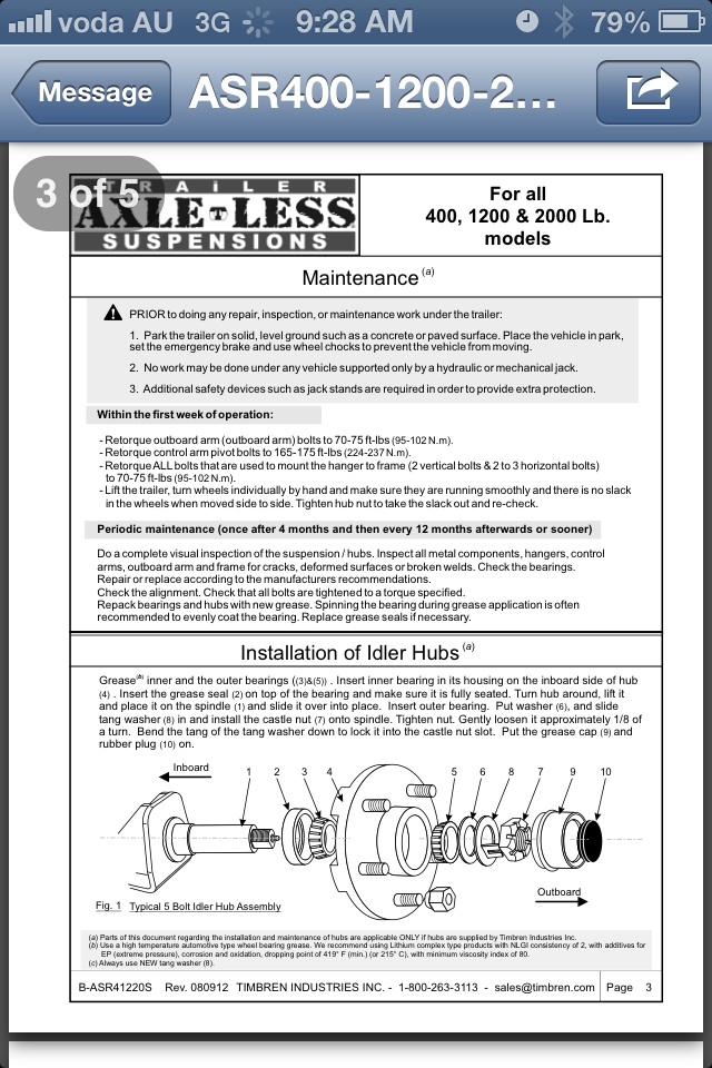

This is the response I got from Suspension Enhancenents.
Hi Mick,
Your problem is one of those problems that the Timbren Axle Less or Silent Ride Suspension will resolve.
Due to the Nature of the Aeon Springs and their progressive operation they will remain stable and provide a far softer ride than any other product even being towed as an empty trailer.

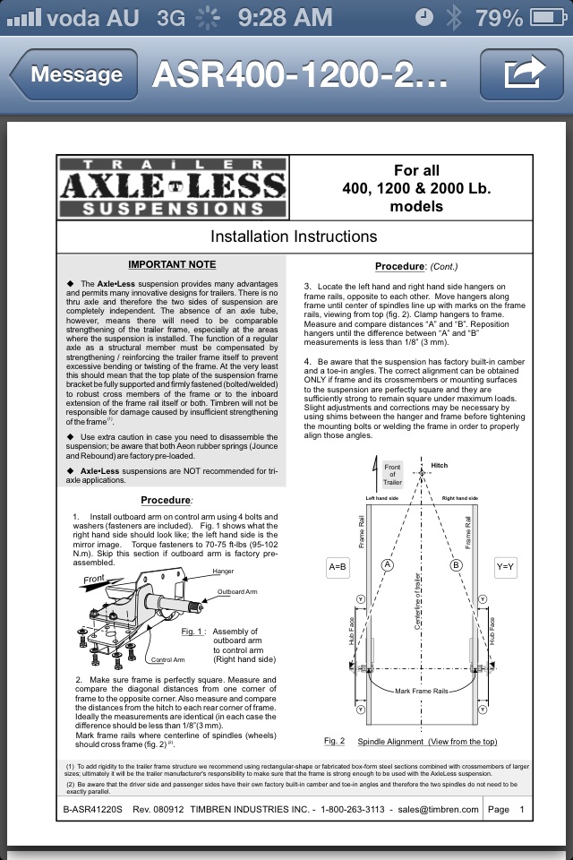

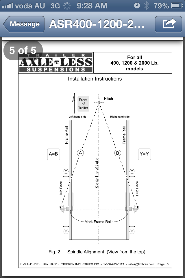

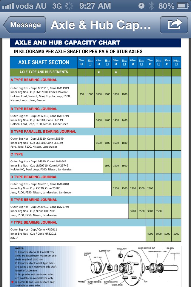

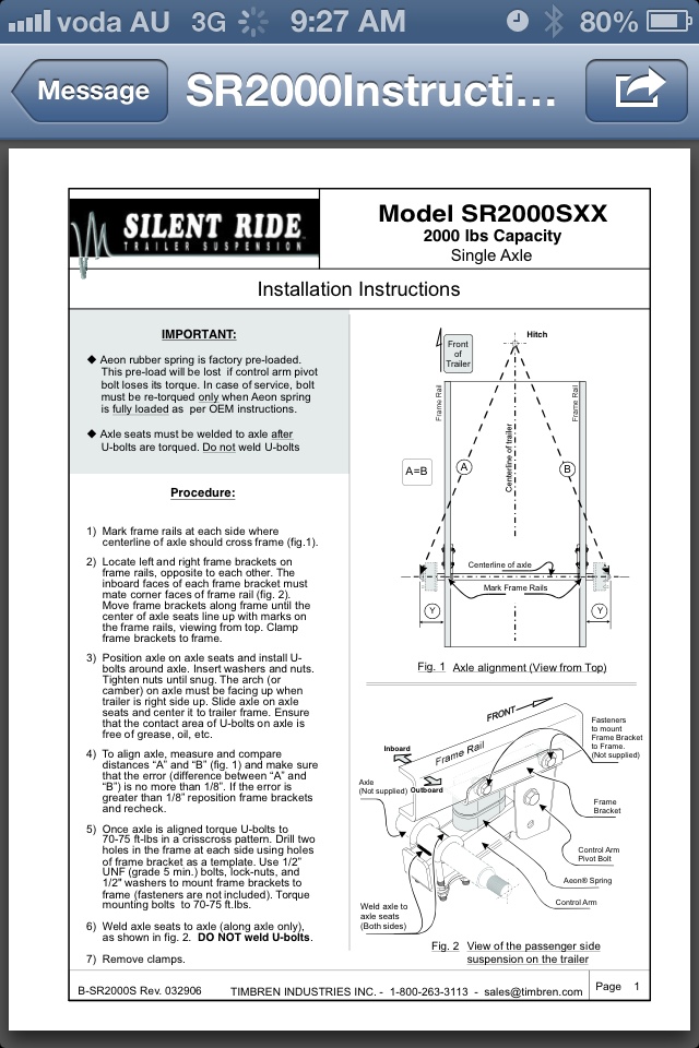

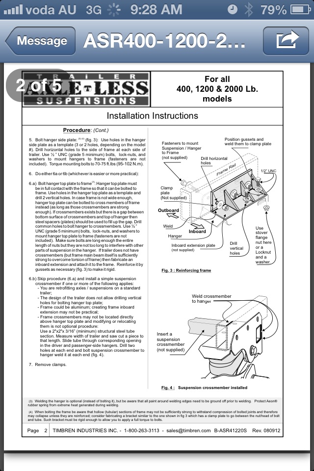

What you need is the 2000lb/909kg Axle Less Suspension or the 2000lb/909kg Silent Ride Suspension the difference is the Silent Ride has an Axle shaft. It could possibly be the one you already have on your trailer. I have attached an Axle Chart so that you can check that it has the capacity for the extra weight. As you will see you need at least a 40mm Square Axle or 45mm Round Axle to carry up to 1000kg.
As the Trailer frame sounds pretty light I suggest the Silent Ride may be better choice as the Axle Less puts a bit of Twist load on the Trailer Side chassis rails and may need some reinforcing, however it has prevision for you to fit a cross brace in to it to resolve that issue. Unless your trailer is really light the Silent Ride should just about bolt straight on. I have attached fitting instructions for both so that you can see and evaluate the difference.
The 2000lb/909kg Silent Ride is $560.00 and the 2000lb/909kg Axle Less with Ford type Stub Axles is $895.00, these are kits include left and right Suspensions plus stub axles in the case of the Axle Less. If your current Hubs are not Ford bearing compatible you would need 2 Ford Hubs for the Axle Less Suspension which would cost you $65.00 each, that’s with a stud pattern to suit your current wheels.
