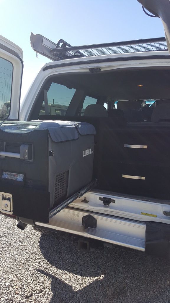

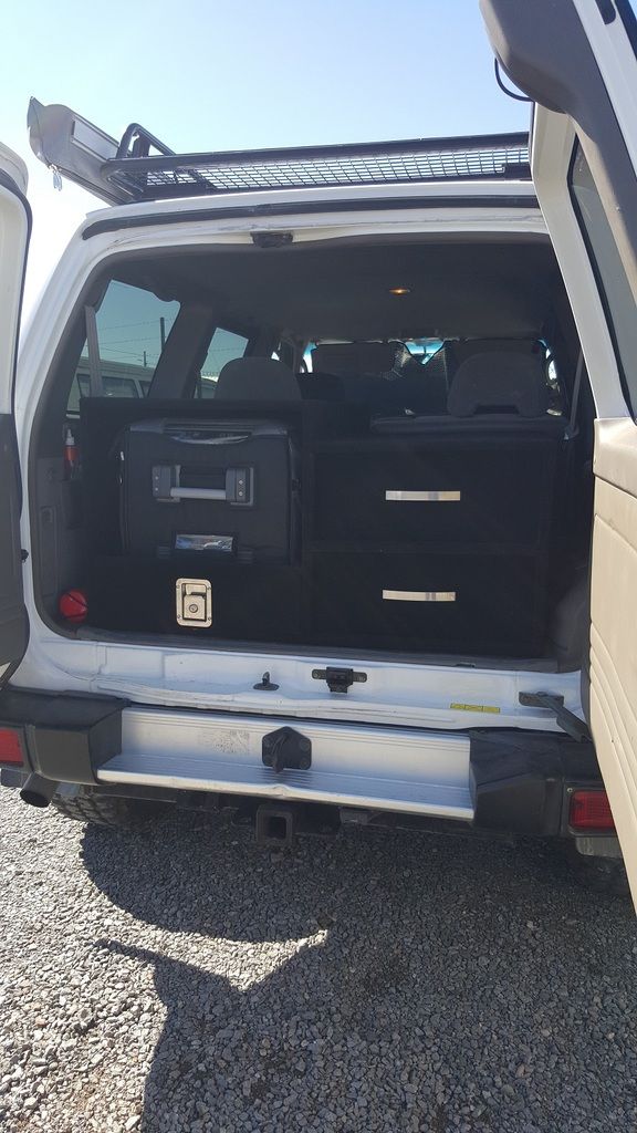

well after months of having the drawer system built i thought i better get off my behind and finish my fridge slide.
The slides i bought 'Lock out' but they don't lock in that way i could use my own latch for the front.
Works great and matches in with the drawer system as well. Having a new Waeco CFX model, they have nut-serts in the bottom of the fridge so a few holes though the base panel and fridge is bolted down.
Now just have too get out for a weekend and test the whole lot out haha
http://i1212.photobucket.com/albums/...pswqdwup7q.jpg
http://i1212.photobucket.com/albums/...ps9g0u931y.jpg
Looks pretty damn good fletch :)
Looks crap as usual Fletch...lol

Looks awesome mate! Something I need to sort out in mine. After I do the lift pump mod and change over the inlet manifold. Lol.
I thought to have two drawers to one side so the fridge is lower. Saves buying a drop down slide.
Nice Rig mate!!
