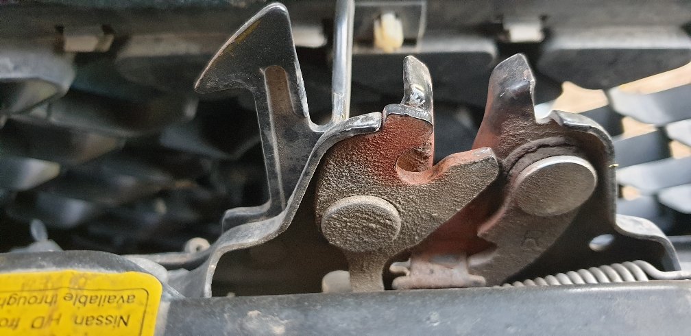

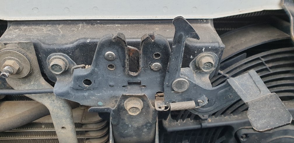

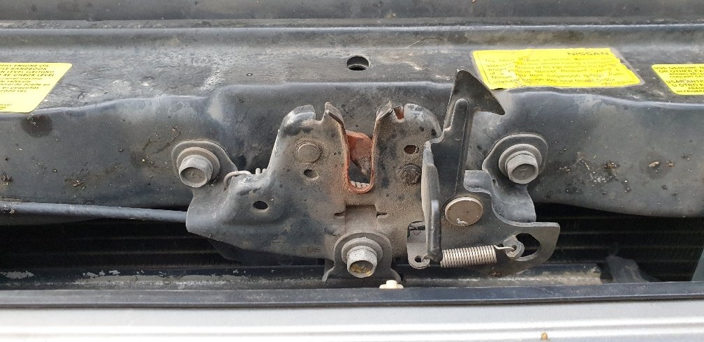

Couple of snaps, with the bonnet release already activated. Is this the neutral or ready to close position of the bonnet catch?Attachment 82660Attachment 82661Attachment 82662
Have you tried manually actuating it mate? The second pic looks incorrect but the third looks right to me
Nic, the second shot is the rear view of the first shot, so you think this is partially closed? the third is just the catch bar in the bonnet for reference. I can push the catch downwards, but not so the throat of the catch itself is empty. I was hoping somone could check and post a photo of the catch on an operating bonnet catch for reference? Its a total mongrel to push the plate downwards, and going backwards looks impossible - maybe its faulty?

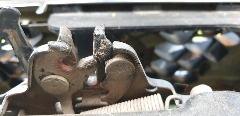

Phil have attached a couple of pic of 08 GUIV Fwd/Aft, a bit different in the way brkt stops latch from rotating when in open position but your latch looks correct to accept bonnet U bar to lock / closed.

These are finally making sense.. all these years I thought they were a POS 😀Attachment 82674
