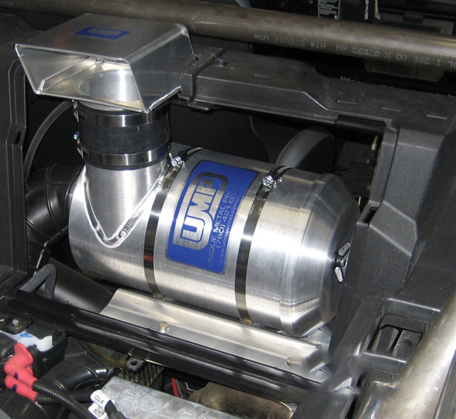

A ram head will seperate the water and heavier particles. It creates high speed air which travels athrough the small openings at the bottom of the slots.
No ram head will pull more water in than not.

I prefer the ram head as it reduces the bloody stupid noise and the rain going into my snorkel was a real concern.
Mine is from a truck spare parts place but can be found on ebay.
It is a donaldson ram head.

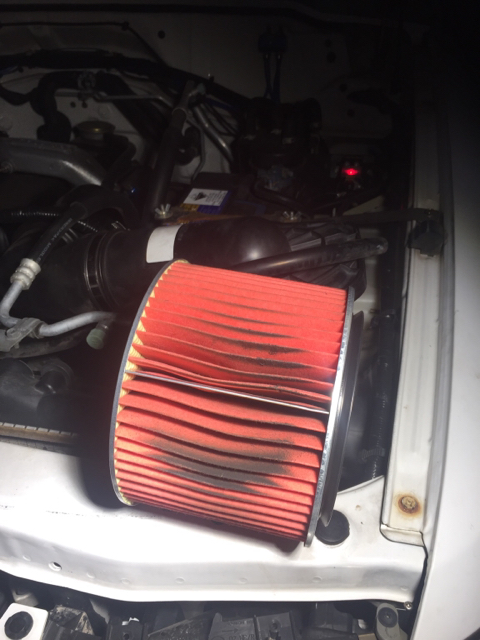

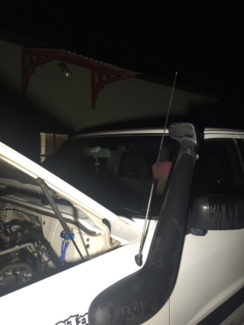

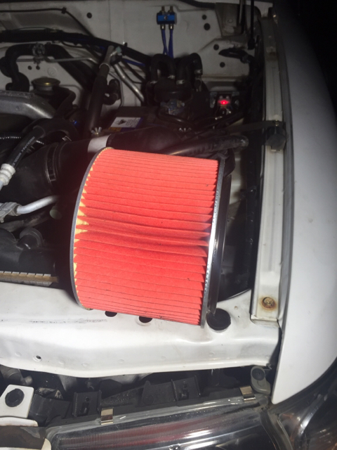

Further inspection of the Mrs GU (Airtec) just now found her box is actually still wet :-)
http://www.nissanpatrol.com.au/forum...2016/05/77.jpghttp://www.nissanpatrol.com.au/forum...2016/05/78.jpg
Flip side below :-)
http://www.nissanpatrol.com.au/forum...2016/05/79.jpg
