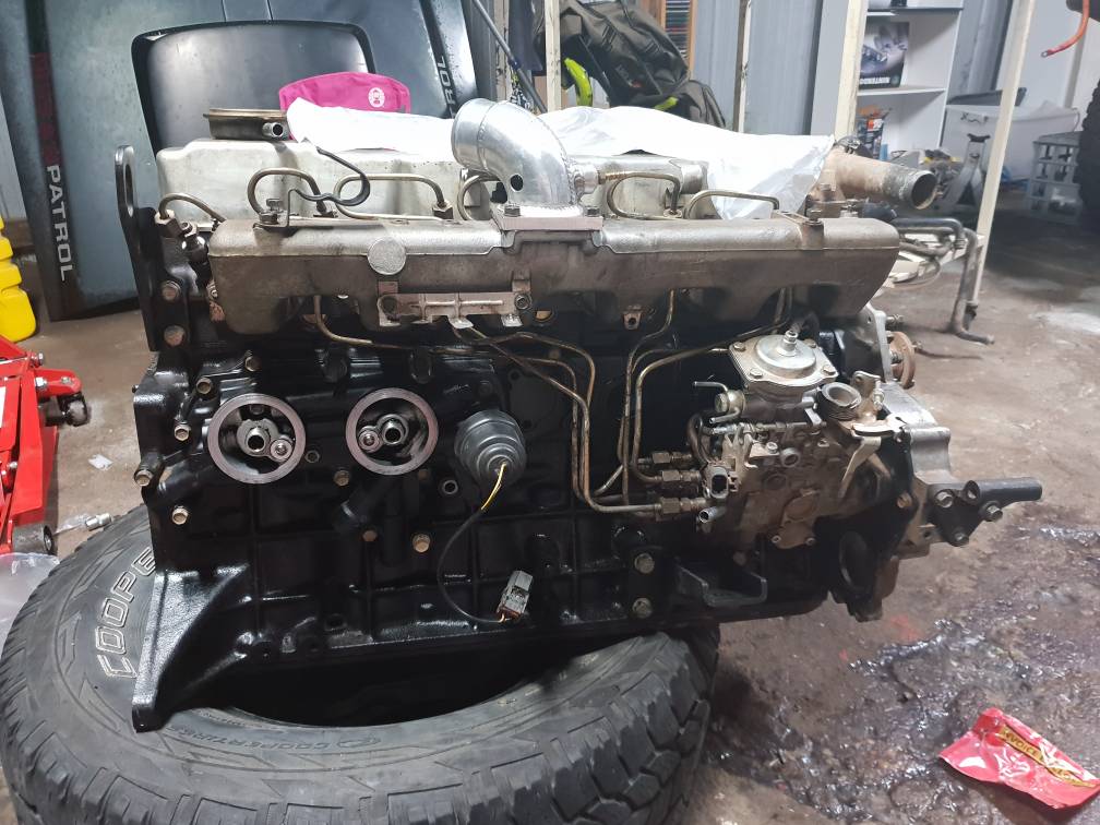

Getting there...
http://www.nissanpatrol.com.au/forum.../2018/11/1.jpg
Need to buy a deep 19mm socket so I can correctly torque the injectors, then we are nearly ready to drop it in.
Look at those spiffy engine mount brackets

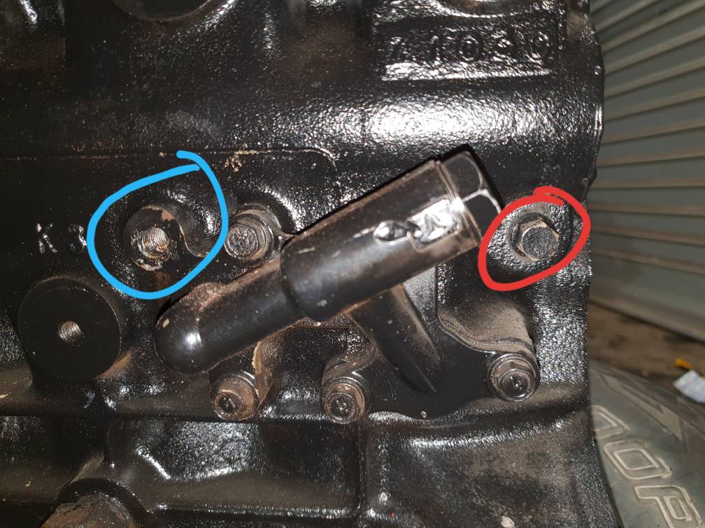

I don't suppose anybody knows what thread size the blue circle is do they? I need to get a plug for it but nothing I have fits it to get the thread matched. It must be imperial?
http://www.nissanpatrol.com.au/forum...2018/11/25.jpg
I would be surprised if its not metric. A fine pitch form at a guess. What approx. size is it? From there head down to the 'bolt guy' and pick up a couple of samples to try. Why do you think It is imperial?
Is the hole a port or a mount hole? It could be AN if for a flow port perhaps? - and this is a US imperial.
See how you go but if not will have one 4 sure in my box of bolts.
Thanks guys. Got a message from Nissan newby and he reckons it's M12x1.5mm
I will grab one on Wednesday now and hope it is right but it does sound good.
Had issues at Enzed this morning, the reckon M10x1.5mm is very unusual and they have had to order stuff in so I am hoping it is all here before the weekend.
Winnie, maybe a typo but M10 x 1.5P is a standard metric coarse thread pitch, about as rare as politicians lies! M12 x 1.5 is equally as common as a metric fine pitch, so no idea why they told you that. It might be a rare liquid fitting though, however they have every adapter under the sun avail t them, again should not be an issue.
I have dealt with these guys a bit and they will slam one in an express bag for you, no problems, just takes a call if you are in doubt with the other one.

Getting there, just need the oil line for vac pump, finish plumbing the turbo, time the pump, grind out sandwich plate and make spacer for tacho sender.
http://www.nissanpatrol.com.au/forum...2018/11/30.jpg
Looking good Chris. I have been working REALLY hard on your new wiring loom as well!!!
