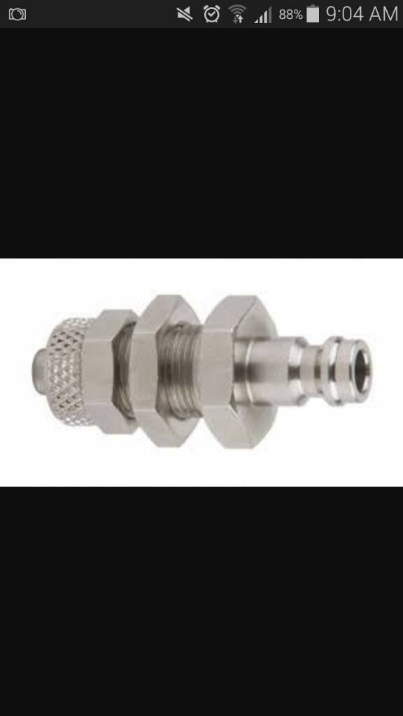

I'm really struggling to find some sorta flush pannel mount air fitting now though......
I may just need to have a regular fitting...
You may need to tig weld a recessed one if you know what I mean.
About 100mm x 100mm plate,,, You know,,, just flicking ideas at you
Not accessible with the draws. The metal sides don't allow access..
I was looking at something like this..
http://www.nissanpatrol.com.au/forum...2016/04/63.jpg
But it would make the hose only usable in my car..
Wouldn't you use the female end with a 1/2" bsp washer holding it tight.
On the troopy I had outlets front and rear, but you need to terminate them
with a female fitting, Then your air hose has the nitto male fitting one end
and a nitto female the other end, That way all your tools will have a Nitto
male screwed to them. Hope that makes sense <<<<<<<<<<<<<<<??
So basically your air gun[blower] your rattle gun, and inflation tool will all
have a male nitto fitted to them, All you need is a short piece of high pressure hose
that will reach all wheels with a female at one end and male nitto at the other end.
Length is normally about 2.2 mtrs long
