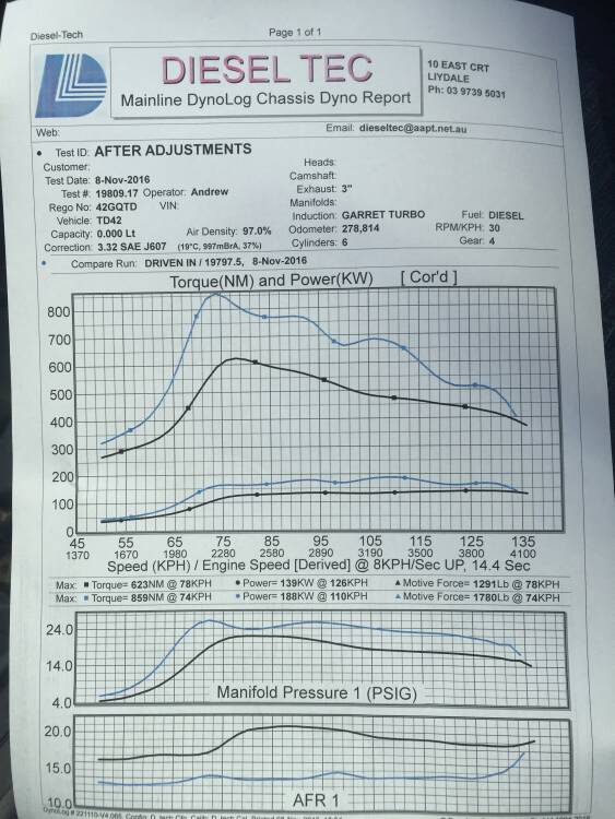

So my car drove into diesel tec this morning with 188kw and 859nm of torque.
Unreal! But a very unsafe car to drive. Turbo was well and truly being overworked.
It is now running a much smoother and much safer 139kw and 623nm

Do you know what the boost was hitting pre tune. Must be hangn to drive it, what it is on paper is one thing but the proof is in the pudding sounds like it should drive very nice now. Know when your picking it up yet?
