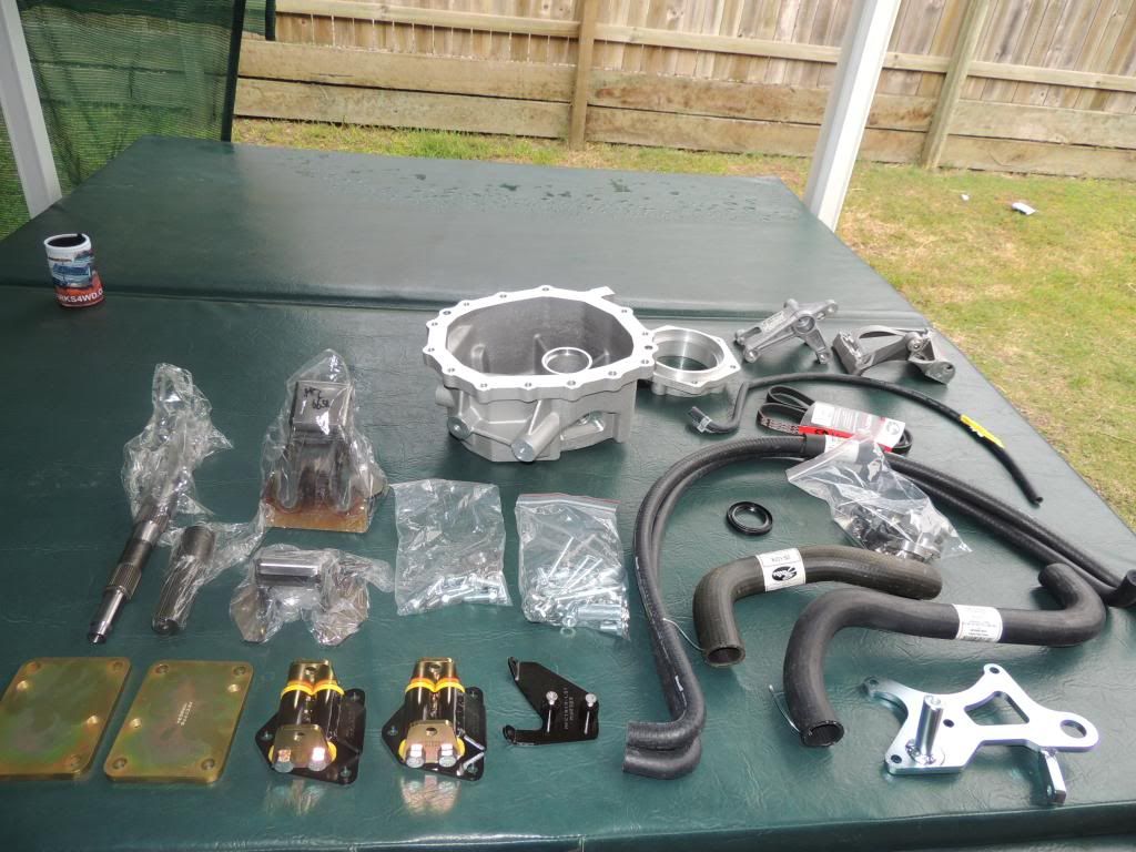

The LS1 with the alternator relocation, New air con pump bracket, engine mounts and power steer res relocation bracket.

A bit of an update.I had the gearbox rebuilt with a stage 2 shift kit, kevlar belt, corvette servo, Z gate clutch and a billet torque converter with harden spline. I have now bolted it all together. The only issue i have is that the flange on the end of the drivers side extractor just touches a fin on the bellhousing.
