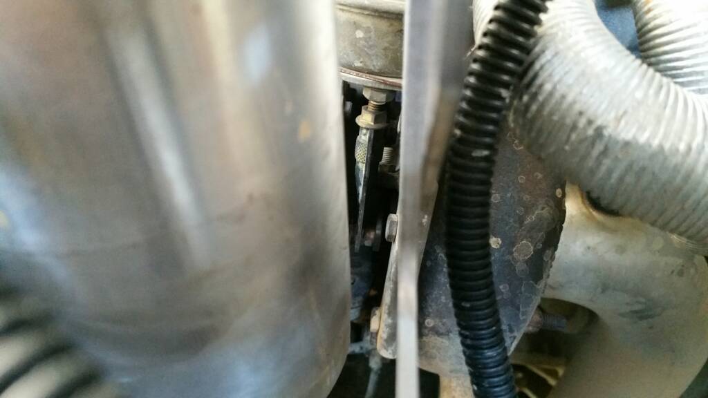

Theres yellow paint marker ontop by grub screw nothing on the actually arm i dont think.. will take a pic and post it up tomorrow...
Sent from my SM-N915G using Tapatalk
Yeah where you can adjust the arm i mean. If the two paint lines dont match up, its been played with before. If so it might be a contributing factor...

Turbo actuator looks ok? Finally after playn with the dawes n needle valve all day the best i got it is boostn arnd 17psi... no bouncing of boost on the gauge.. smooth linear power delivery... wil just have to keep it like this until i get that ecu talk gauge off ya mudski... i think i might have a faulty tps hence why it wont boost as high and feels slugish even when i jump on it.. plus yhe randm idle up issues...just easier to trouble shoot everything... also been lookn into getn diesel smart xt module.. 25kw increase at the wheels.. eliminates limp mode.. has timing control over ip pump and 5 preset tunes... and maybe put on one of there acutators aswel... get rid of the whole vac system altogethr... more $$$.. dont knw which is more exspensive 4 wheel drives or old school v8s...[emoji12]
