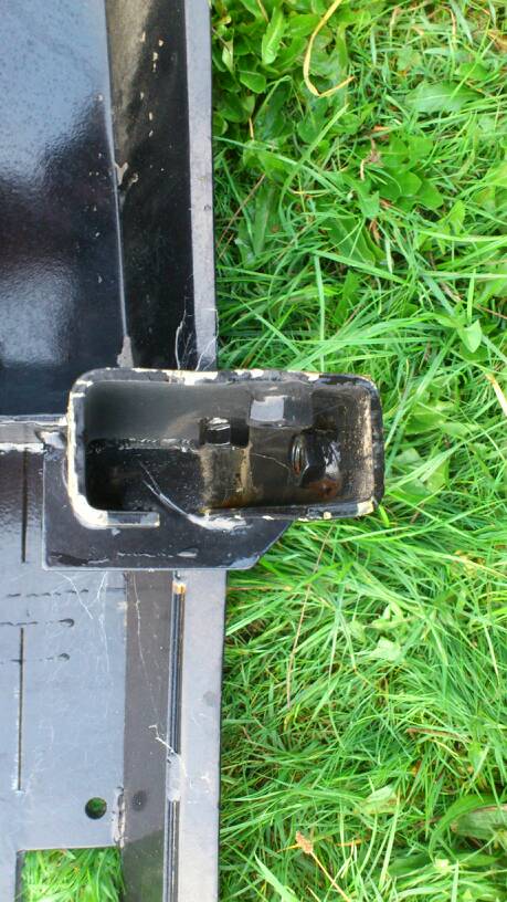

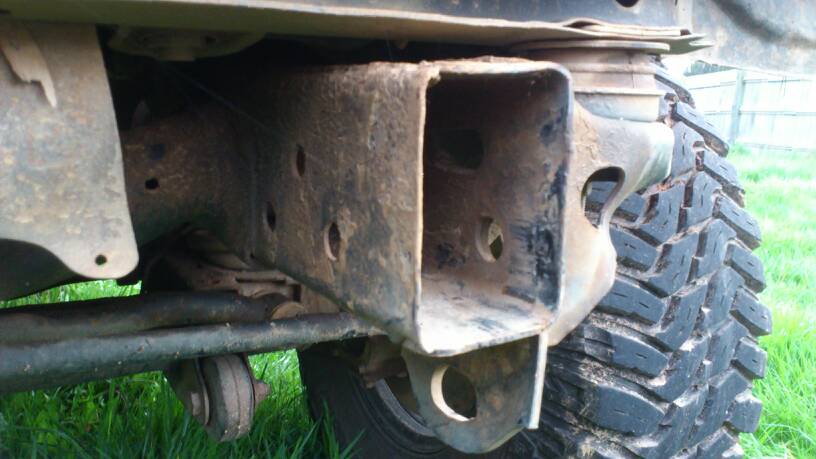

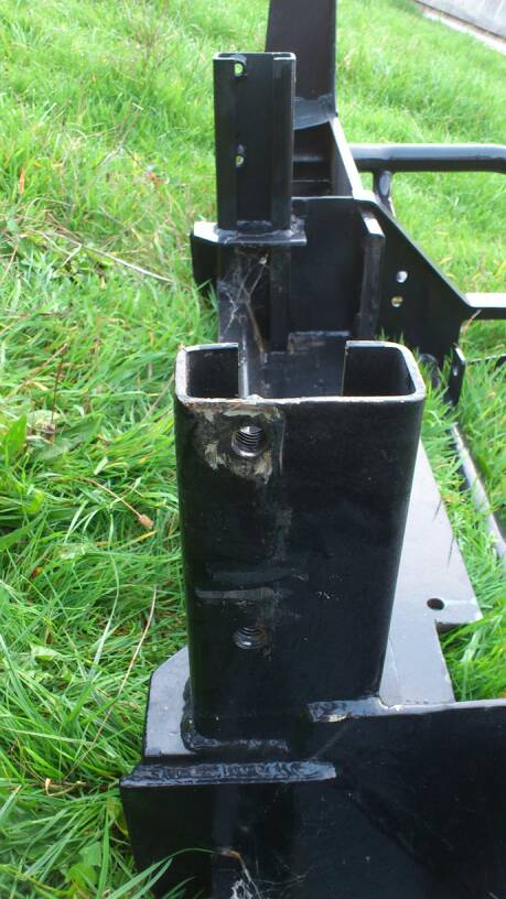

Nah it's a different set up altogether. The bullbar slides inside the chassis rails. It has three captive nuts per side. When the bullbar is slid in, the nuts line up perfect with holes in the chassis rail. The six nuts appear to be the same. I'll get some pics after work.

This slides in the rail aswell
Attachment 29158

http://www.nissanpatrol.com.au/forum...2013/05/79.jpghttp://www.nissanpatrol.com.au/forum...2013/05/80.jpghttp://www.nissanpatrol.com.au/forum...2013/05/81.jpg
Heres some pics.

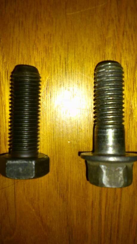

Got a bolt off a mate that screwed into the nut but wouldn't go all the way through so the thread was slightly different. Went to bolt shop today and showed them the bolt they said it was 1.75 thread, gave me some with 1.5 thread and the damn things won't screw in as far as the 1.75 I had?

nah the 1.75 didnt seem too sloppy but i might be used to a diferent level of sloppy haha. i will try 1/2" unc next.
I tried all 6 nuts and they all felt the same (stopped in the same spot). the thread is clean too

What size are the nuts welded to the bar like socket size? If - 3/4 or 19mm spanner is the go for them then the bolt will be half

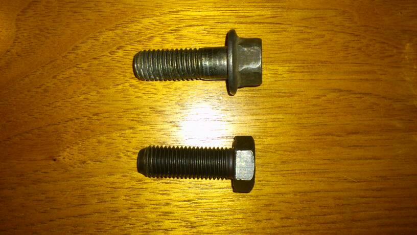

Ok, the top bolt is the one that nearly fits(goes nearly all the way through the captive nut). It has CM 8.8 on it.
The bottom bolt is the one I got from the shop today. It only goes in the nut one or two turns. It has MF 8.8 on it.
The captive nuts are 19mm

http://www.nissanpatrol.com.au/forum...2013/05/85.jpg
Bit better picture. The bolts they gave me today (black) have a lot finer thread.
