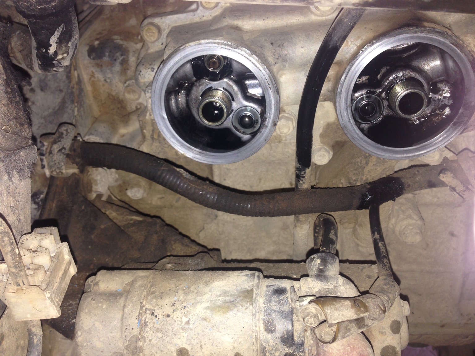

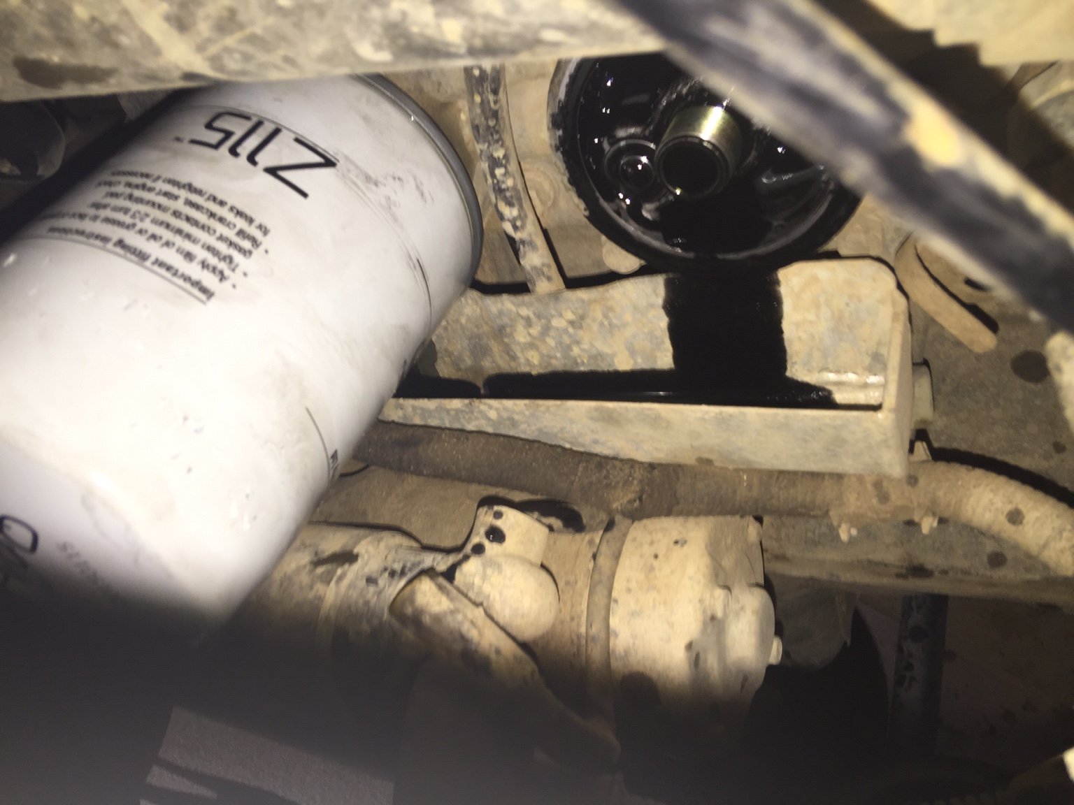

old thread but if u crack the filters till they're loose (but not dropping oil) and then pull the sump plug 99% of the time doin this will suck oil from the filters. so after u drain the sump and put the plug back in when u take the filters off they shouldnt drip any oil. give it a try and let me know how you go
