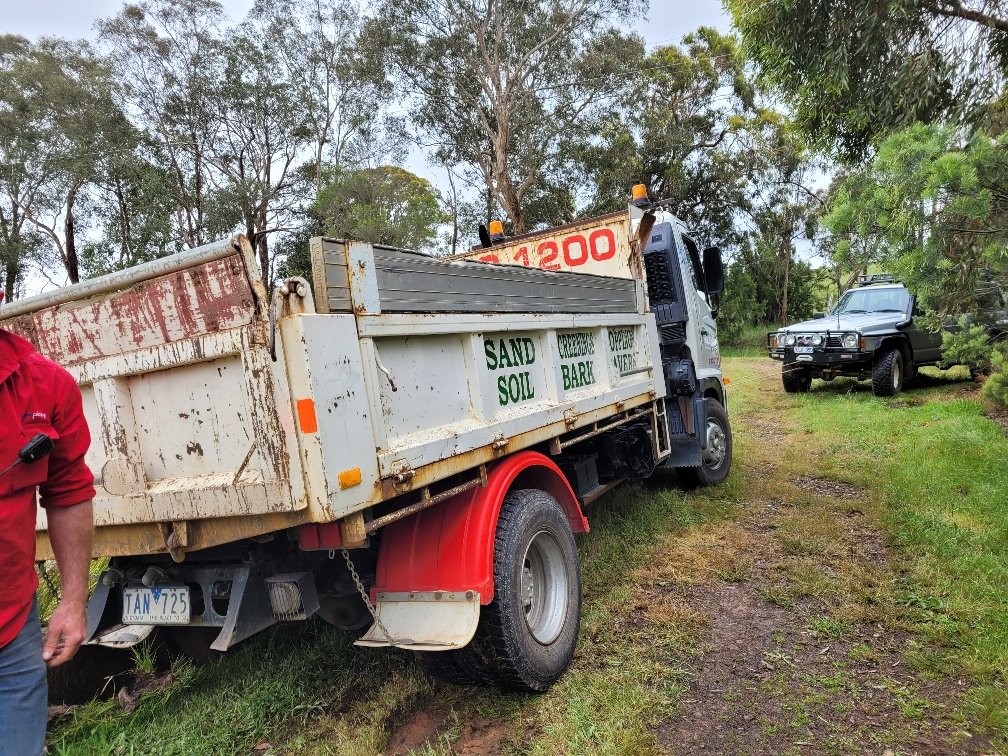

Thank you kindly Rossco Mate, final calculations are in, your morning super helpful 12v double line haul was nearly 11,000kg of single spinner steel and crushed rock combined [emoji23]
http://www.nissanpatrol.com.au/forum...2021/11/83.jpg
Can’t wait to see what your future 24v High Mount assistance can do for our weekend drivers wacky reversing lines [emoji2957][emoji23]
He’s bought you a box of Coopers too, NO Arguments [emoji120][emoji106][emoji106]

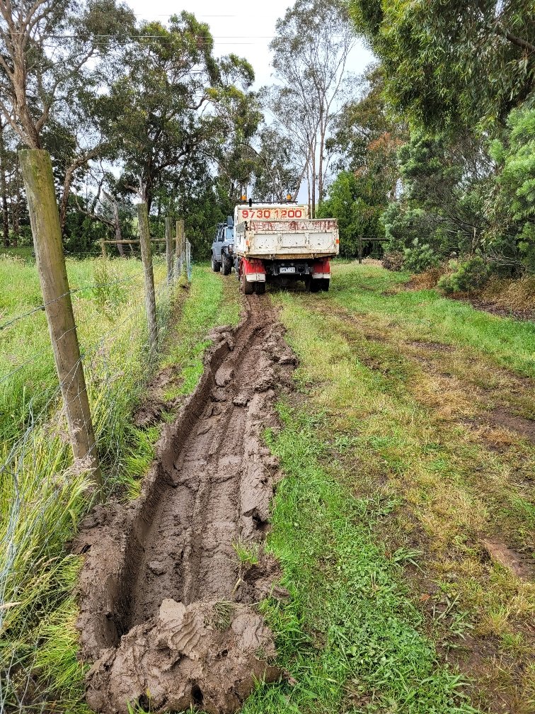

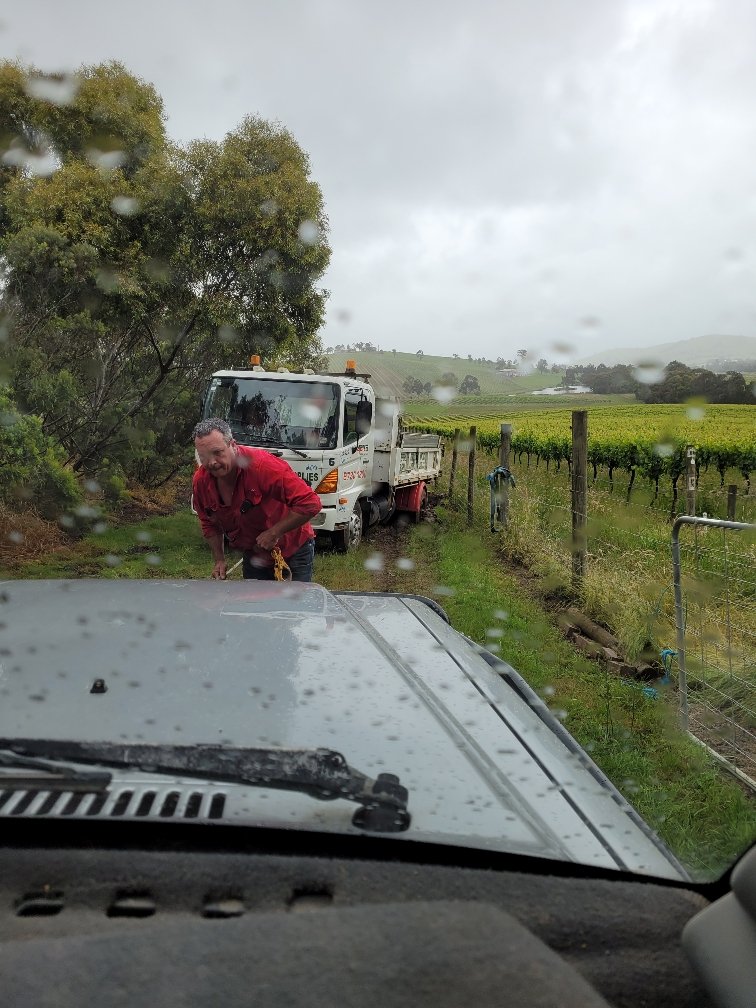

TBH I can't believe it kept pulling bloody amazing those High Mounts really thought threre was no chance looking at that back wheel buried in the goo. . .[emoji106][emoji106][emoji106]

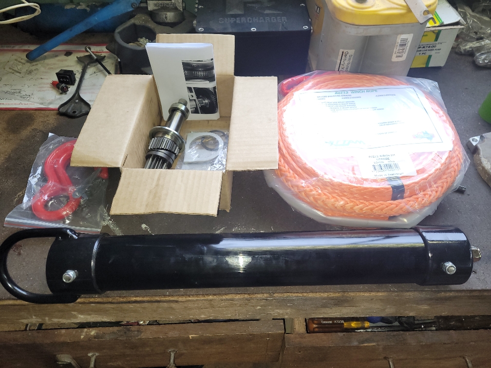

. . Few snazzy bits for the old girl upgraded brake shaft for the HM some new rope & hook and finally got myself a big black dildo to strap on the front. . . Did notice she got unusually hot on one of the scorchers the other day and looks like front of air con condenser still pretty dirty from $1000 dollar track so as brake shaft was on the cards may a well get bar, grill and intercooler off to give a good clean from front side and hopefully all good . .[emoji1696][emoji1696]

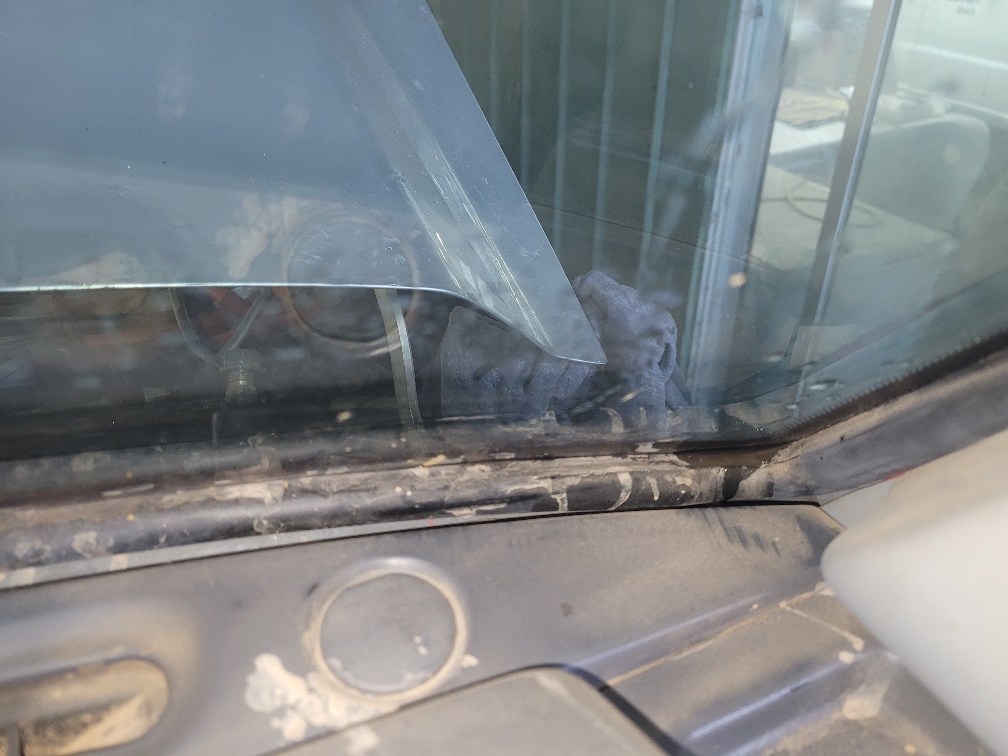

Also found windscreen leak that has plagued me since the rebuild had replaced all scrivets thinking that was it but still no good. . Looks like windscreen seal so at least its tracked down bit so should be able to get it sorted[emoji106][emoji106]

Nice one mate. 12mm rope for the win. Awesome. What diameter us the dildo? Check out Markys. I highly recommend replacing that bottom bolt with a pin and clip so you can take it off while.commuting. winner.
You will be impressed with the brake shaft too. It wasn't until.i fitted one that I realised how much of an upgrade it was, not just a circuit change.
We need to get that 24v pumping mate!!!
You probably won't fit 40m of 12mm on your drum either. When I make the soft shackles I needed about 3m of 12mm per shackle FYI or.make a 10m extension strap (well 7m by the time you splice a loop in each end. Nice fluoro Orange for the win
Yeah old mate who I got the bar off made a 50mm receiver for trailers so will be perfect for mounting removable dildo when in the bush only. . See how we go with rope is actually 10mm tho but should do the trick hopefully. . Think last time out rope on got 40 m and chopped about 10 off to make extension but that was with standard diameter drum so deltatec get a bit more on. . Dildo 75mm think better choice than 50. .
