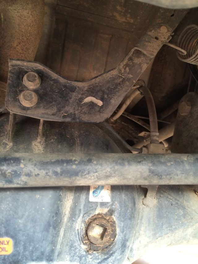

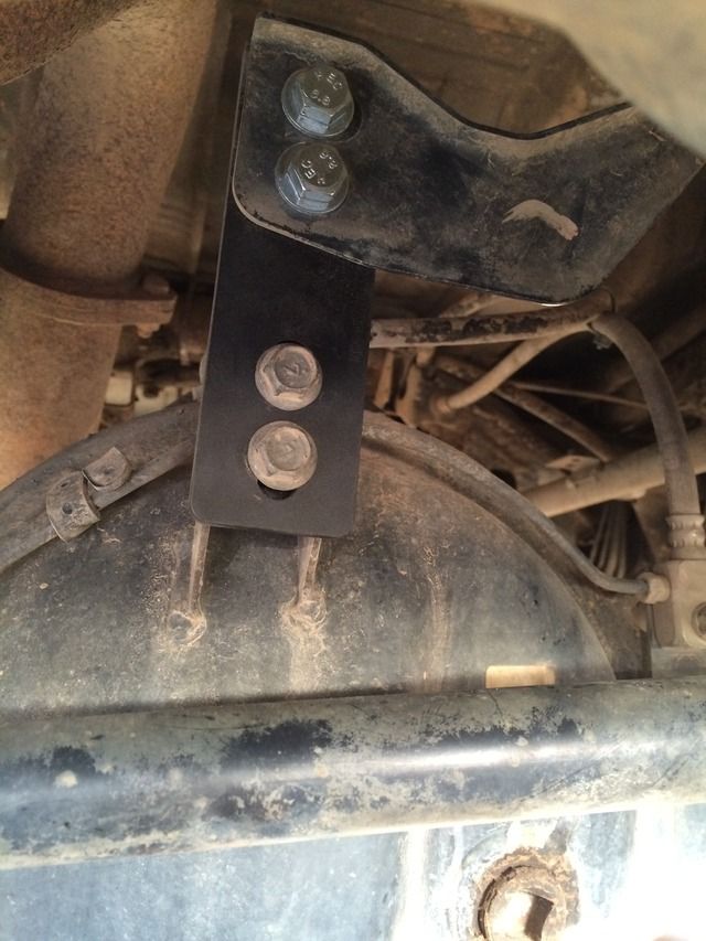

Couple of quick little jobs this afternoon. When whoever put the lift in they never installed the extended brake bias bracket
http://i1083.photobucket.com/albums/...psvtlgzbwk.jpg
So in one went.
http://i1083.photobucket.com/albums/...pswhbdgpk3.jpg
Couldn't feel any difference when driving it but at least now I know it's right.

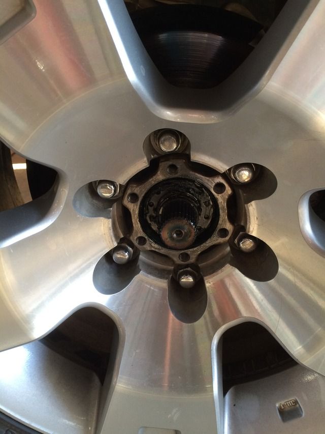

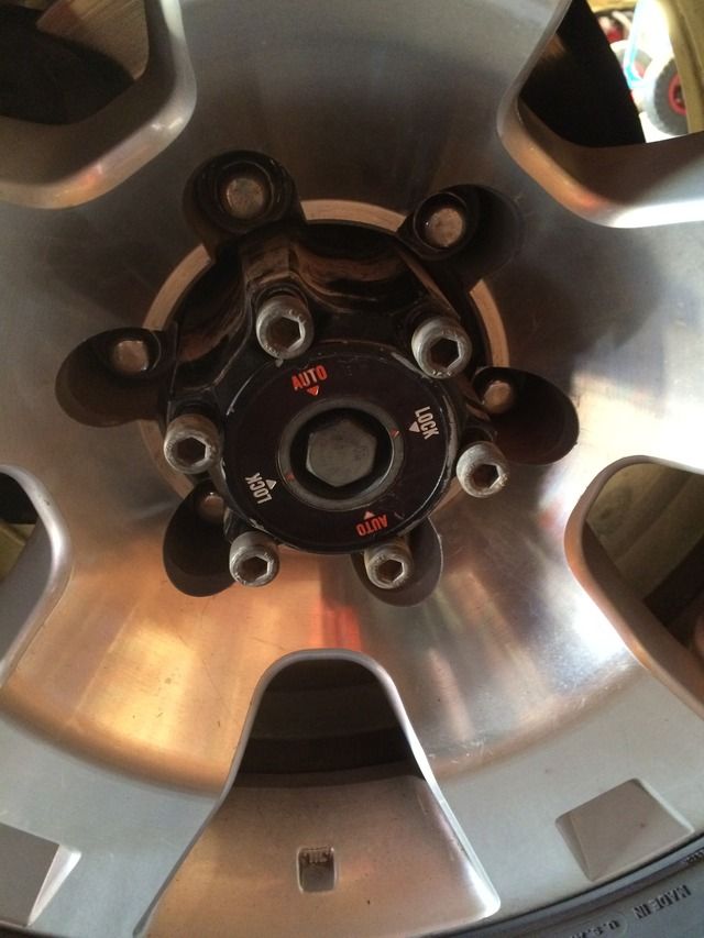

Next came a pretty cool little mod, well I think so anyway. Converting the auto hubs to free wheeling hubs. This allows me to select L4 without being in 4wd and hence winding up the transmission and drive line. Perfect for reversing trailers :D
Lock the hubs, Undo the 6 x 8mm cap screws and pull the hub off.
http://i1083.photobucket.com/albums/...pslhnvuras.jpg
http://i1083.photobucket.com/albums/...psgbfs8vfr.jpg
http://i1083.photobucket.com/albums/...psj71bzmd3.jpg

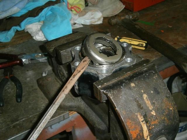

Place the hub in the vice and pri out the locking ring. I found it really tight, but if I tried at a different place around the ring it popped out really easy. So give it a go in a few places and you'll find it pops out with minimal effort.
http://i1083.photobucket.com/albums/...psict21e6h.jpg

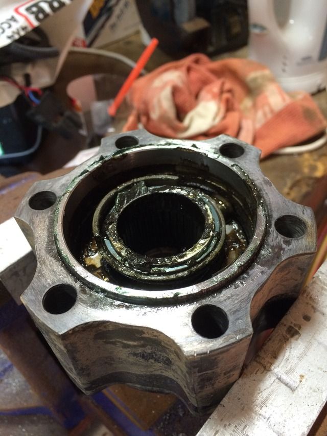

This is what the hub looks like with the locking ring removed.
http://i1083.photobucket.com/albums/...psjjmqcuw8.jpg

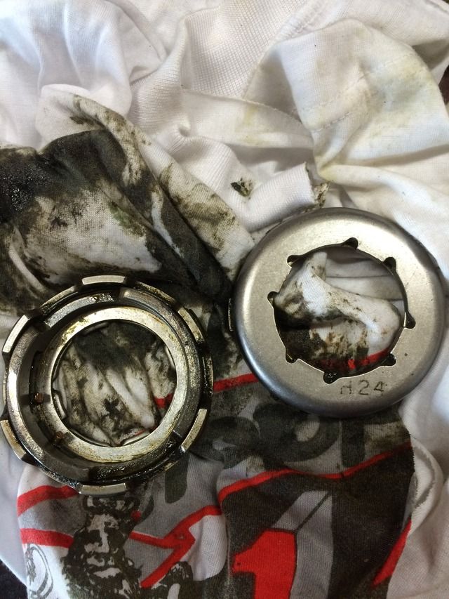

This is both the locking rings (one from each hub) one is upside down one isn't.
http://i1083.photobucket.com/albums/...ps1qqrcgwe.jpg
Now just put the hub back on and you're done. The whole process should take 10-15 minutes if that. :D
