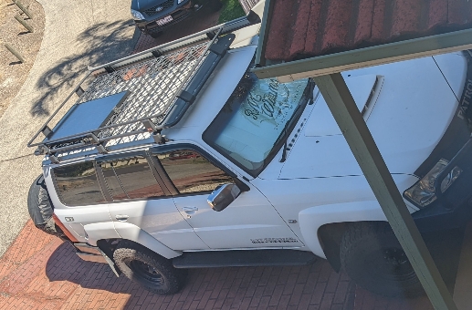

I know that some of you have a fixed solar panel on your rack.
My question is what size panel should I be looking at. I run a console fridge which I turn off when I know that I'm not driving the car for a day or two. I have forgotten and have found the fridge off and the battery low. Is 100w too little and is 200 too big. I just want to keep the battery topped up

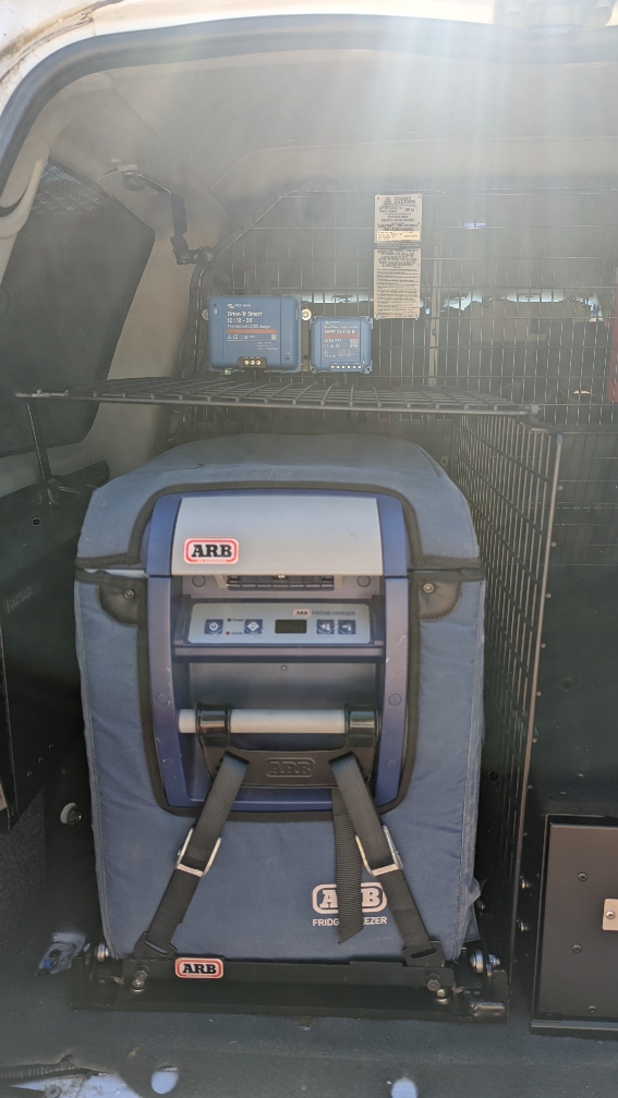

I have a 110W panel on the roof. It charges a lithium battery which feeds my 47L fridge which is on 100% of the time all year round and unless I'm stationery camping the setup never falls below 90% battery charge all year round.
I use the Victron 12V gear.
Again like I said above. It depends on the rest of your setup. But for me the small-ish 110w works perfect. And if I need extra juice. The 120w solar blanket plugs straight in.

I run 2 x 200W panels on my rack. I went up from 2 x 60W shade tolerant canon panels that served me well, however I am a wasteful power pig when camping and want my food icy cold and drinks the same, plus run any amount of 12v gobbling appliances. Remember the power output is at 100% output and you are going to see maybe 60% at best of time, and its for a limited amount of time during the day, efficiency drops above 25degC ...blah blah. Anyway these keep my 400ah charged up nicely in 40degc and i am happy. .
I have a kings 120 watt solar panel on the roof running thru a MPPT kings controller. Supacentre is not bullshitting their specs like a lot of ebay sellers, it is 120 watts and it is MPPT and it is a fair price. Solar panels… 1 square metre of direct sun light = 1000 watts. At 18% efficiency a typical 1 x1 metre solar panel will max out at 180 watts. Remember this when you buy off ebay.
My kings setup runs my second shitty lead acid under bonnet battery with VSR which powers a crappy aldi 40 lt fridge all year round, with room to spare for the occasional travel buddy morning tea. Weekday driven about 50k to work and back😀

Sorry forgot to mention the battery. It's a 140ah AGM.
I'm looking at this.

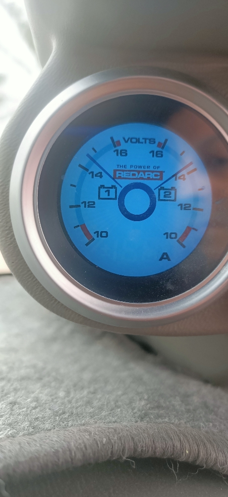

I'm currently using a basic redarc sbi12 isolator, what's the go if I install the panel, will both be feeding the battery while driving?
Fridge is connected to aux battery.
I have a slide out 100w panel under my roof rack because it’s only a 3/4 rack. The slide is simple square ally tube on each side running in ally angle slung underneath.
It has to be pulled out to be efficient. I’ve measured 5 amps on a good day with my clamp meter.
I don’t use a separate controller, I have the solar input on the DC/DC charger.

I like both these concepts, however will need to see what I can make work. The HH antenna on the rear might limit my rear options, and the rack support legs might be just that bit close for the side - thinking .......

You'll love that Panel John mate. Love how the sides are powder-coated almost the colour of the roof rack so it doesn't stand out.
I've had mine for a while. I've throw everything at it, on top of it, from swags to chunks of timber. It's been hit with a strap buckle so many times but not a scratch on it.
But DO NOT try drilling into it like some goose I know...... See my post below. Tempered glass.

Also I've ordered another redarc isolator sbi12d, the current one hasn't got the duel sensing. That will be just a straight swap out yeah?http://www.nissanpatrol.com.au/forum...022/01/197.jpghttp://www.nissanpatrol.com.au/forum...022/01/198.jpg

I started with mounting the panel and I need to drill some new holes so the lines up with my rack.
After flicking through the book, it's if you want to run a constant low power consuming electrical device which I'm not.
As for the regulator Hodge I will run with this one and see how it goes can always change if I need to.

Job done.
Run out of some tidy up bits , but there's a bit that that wanna clean up.
Only thing I'm not too happy is how the cable enters the door. Was thinking black electrical tape along that section (one of the things that I run out of).
Should get the new redarc isolator on Monday and that's a swap out.
