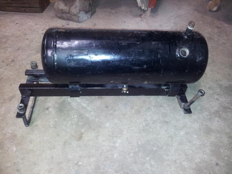

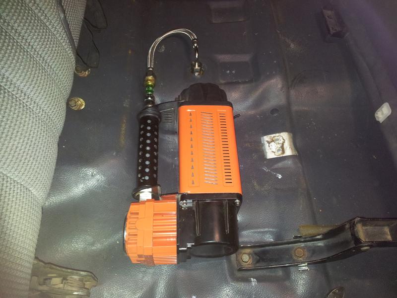

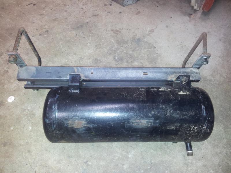

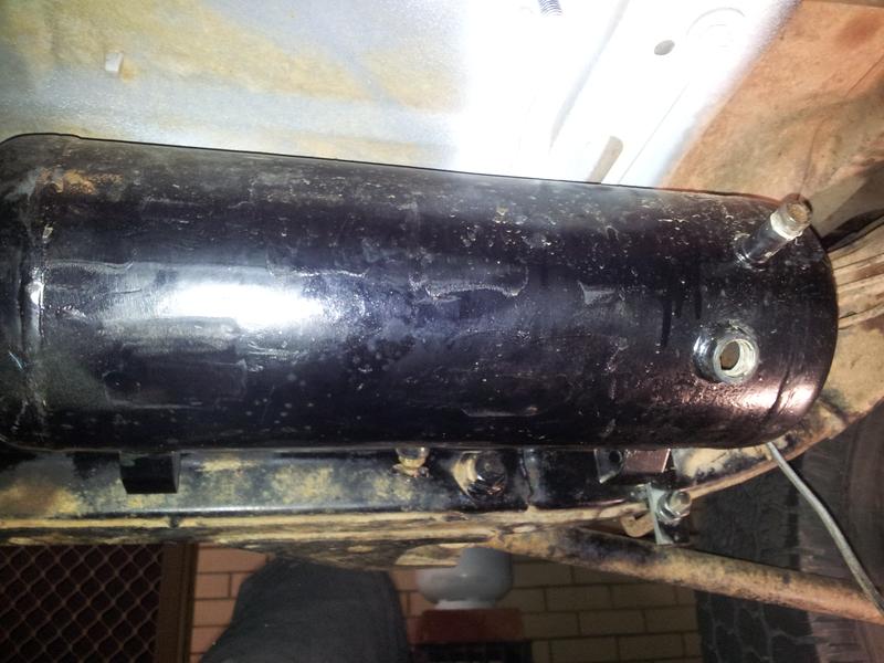

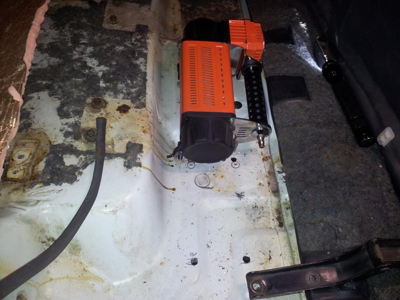

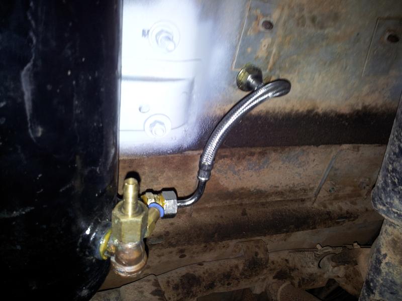

Compressor with external tank build.
Nice mate. How big is that tank?

Lol mate, gee no beers?
Tanks 8 litres.

@ Kallen check onboard air for all the different tank sizes,
Available in alloy or steel, multi ports as used for Doof doof cars
Had a very nice 600 x150 alloy 6 port job in other 4x4
Have alook at this, remove all the electrics.
Go to the suppercheap website and have alook at the Blackridge Air Compressor - Direct Drive, 1HP. 8litre tank 80$

Is that 12v or 240 unit? cheap pressure vessel, pressure switch and pressure control valve with reg though for sure!
Only cheap if all the bits are low voltage..
Owner of
Westy's Accessories
With all the bits left after taking the motor and compressor off you have to be in front I reckon. The pressure switch will handle the current through a relay but not the compressor at 12VDC.
Drain, pressure switch, fittings, regulator, gauge and tank for $80 sounds good. Most probably from that cheap manufacturing country but it will do far a while.
Add a 12VDC relay and 12VDC compressor plus a few hoses and fittings could be a winner.
Looks like Silent has used the same stuff in his DIY project here, not sure but looks very similar.
Yea fair call.. cheapest tank I could find is around the $70 mark so yea it is a good option..
