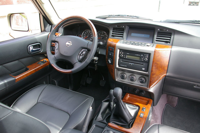

    Since the compatible Nissan car models our D5168 fits doesn't include the Nissan patrol, we want to know if it's really fit or not.Is the Nissan Patrol has the interior as follows?
    If so, I've asked our tech, our D5168 should fit the Patrol's dashboard shape. But could you please kindly tell me the dashboard size to make it even clearer? Is it a standard 2 din size? Since I've seen some guys have installed our 2 din G2216 and G2227 without problem.

    If its a standard Nissan Double Din unit it would fit in the Patrols, only issue would be how it connected

    The pic above is of a Left hand drive GUIV and above and is still the current Y61 shape throughout Australia.
    The audio unit is a Double Din size and i understand that your unit is widely used and sourced off ebay.
    The screen at the top is the Nissan factory GPS and reverse camera setup and was an Option only. I do not have that option and instead have a small glove box with a flip up door in that location. I do not believe there is any connection between the radio and the top screen as they are independent units with no cross options? I might be wrong though?
    Just looked at that pic again and advise that my radio unit is a single unit of Double Din size and is Not the same as that unit. it does not include a DVD and i believe that no unit is Australia will have a DVD that signals to the dash screen as it is illegal to have a DVD play in the view of the driver. So if there is a DVD in that car in Australia then it would be for the optional Roof mounted screen for rear passengers only,.
