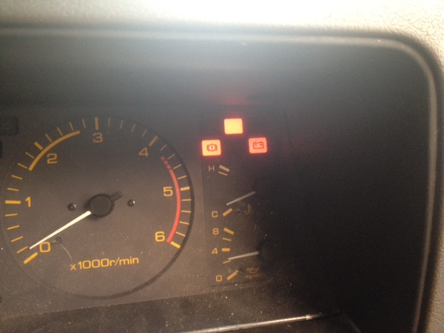

    Owned my Safari for a few weeks, first time I've heard a chime, and I have a light on the dash that blinks before I start the engine.
    top middle light is the one that blinks

    I can't remember what that one is. What is the symbol?
    Can you take another photo to show what the symbol is for the middle one?

    Now that you mention it im not sure what that light is. When I get home from work I will have a look at the manual and post what it says tonight.

    I have a cluster here it has no symbol for that one on it but according to the back of it a/t oil

    a/t oil temp warning i have one in my auto diesel gq

    Yeah - I've seen a Auto saffa, it blinks 10 times then off when key is in ON position. Mines a manual, and doesn't have writing on the light like most peoples. Cheers

    I think some Safari models had a "don't forget to put your seat belt on" warning light and chime, maybe it's for that.

    oh, is your engine running in that photo? or just the ignition on? either way you have some messed up gauges and possibly an alternator fault.

    lol look where it is idling

    From the Nissan Owners Manual: Automatic transmission oil temperature warning light, this light comes on when the automatic transmission oil temperature is too high. If the light comes on while driving, reduce the vehicle speed as soon as safely possible until the light turns off.
    Continued vehicle operation when the A/T oil temperature warning light is on may damage the automatic transmission.
    As far as I'm aware, the light will come on with ignition and go out when running
