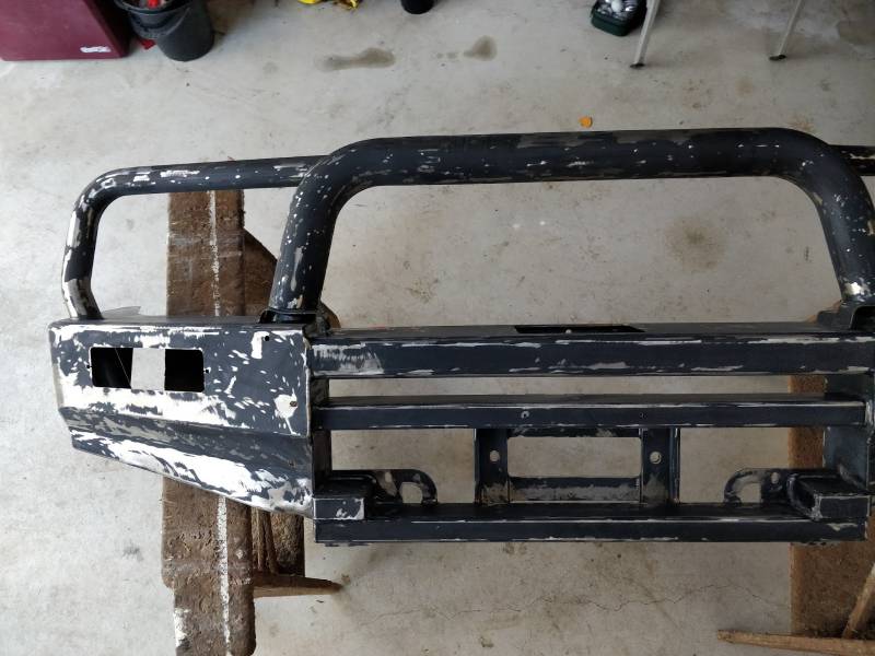

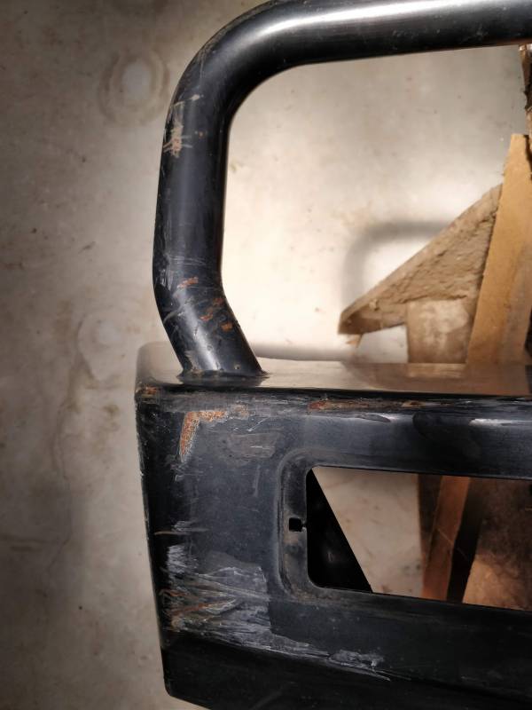

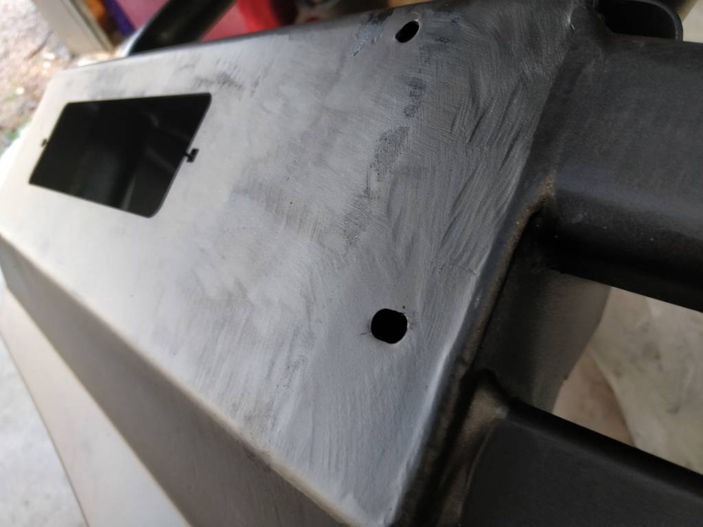

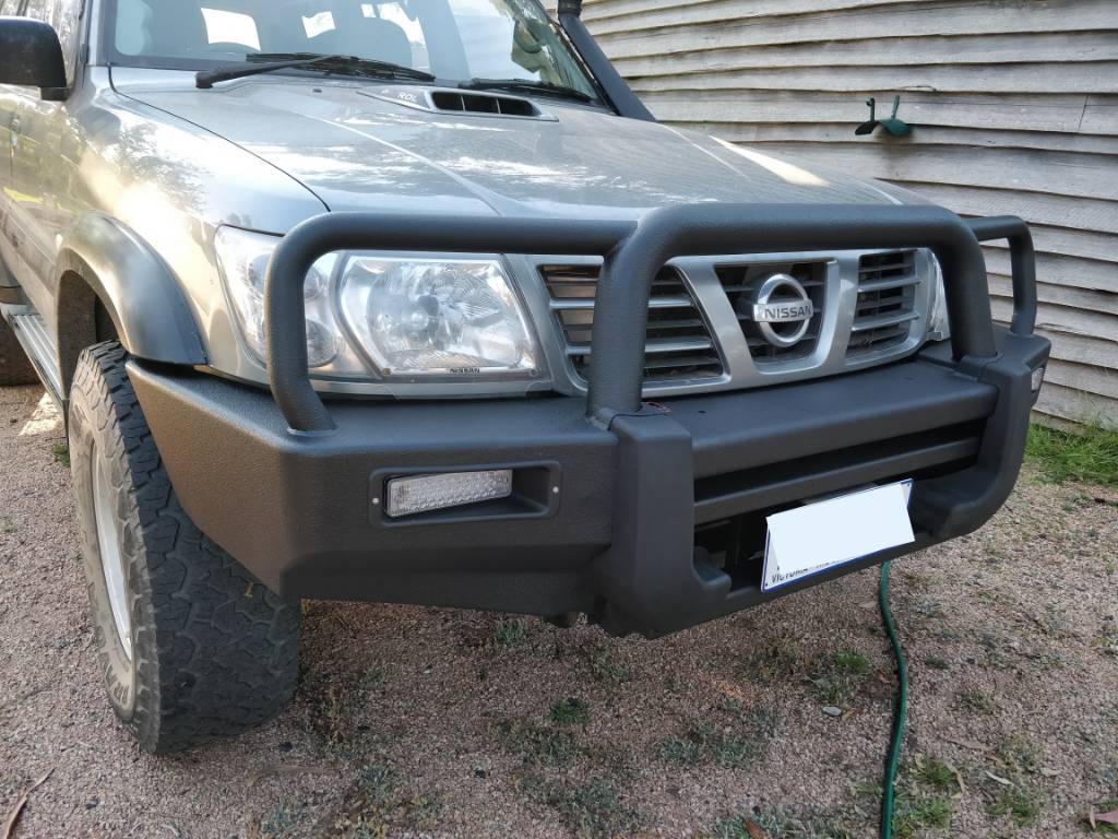

    Quote Originally Posted by Mickhead View Post
    Raptor it!

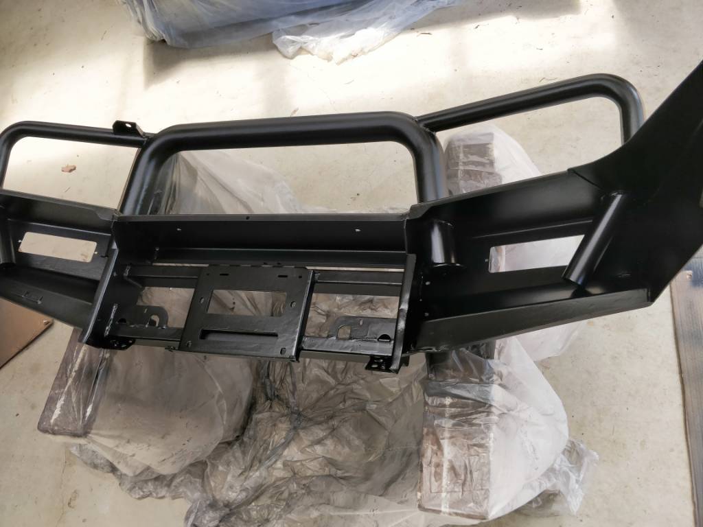

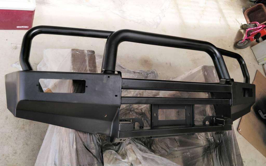

    Fitted the bar last weekend. I hadn't considered raptor coating it until Mickhead made the suggestion but it really looks great!
    Cheers @Mickhead
    First thing I've had a go at spray painting too.
    Base coat with a metal shield epoxy enamel and then one bottle of raptor to do the front.

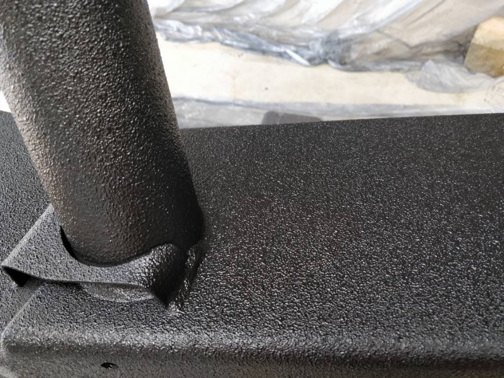

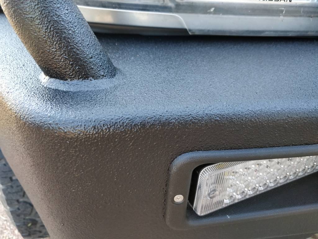

    Is this raptor paint actually harder than standard 2 pack? would seem its going to be harder to wash with all those rough pockets? I do like the matt look though.
  12. #5328
    Jun 2018
    629
    2,859
    Thanked 935 Times in 442 Posts
    25 Post(s)
    It has a hardening compound that you mix with it before application.
    The paint is actually like a soft jelly before you add the hardener to the bottle.
    Hopefully a high pressure hose will be all that's needed to wash it if required.

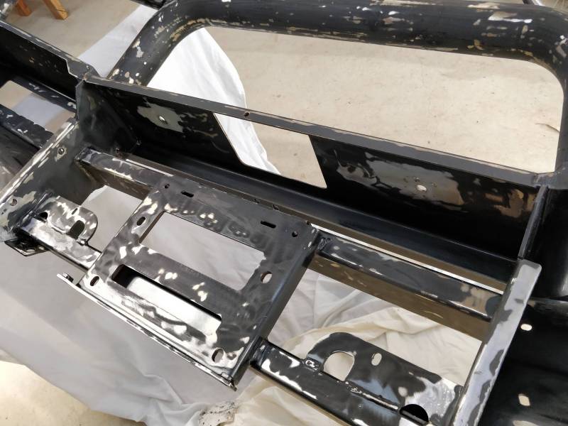

    Edit: best part was that I didn't need to get the surface preparation perfect and the raptor covered any rough areas.
    You can see in this photo what it looked like after paint, but before raptor.
