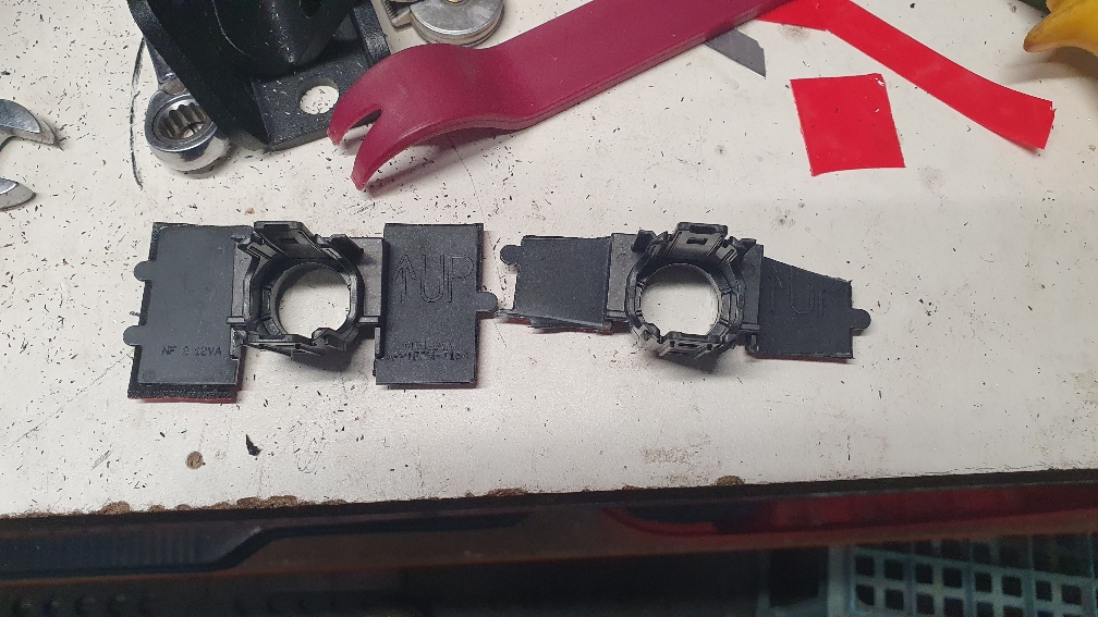

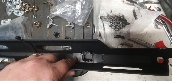

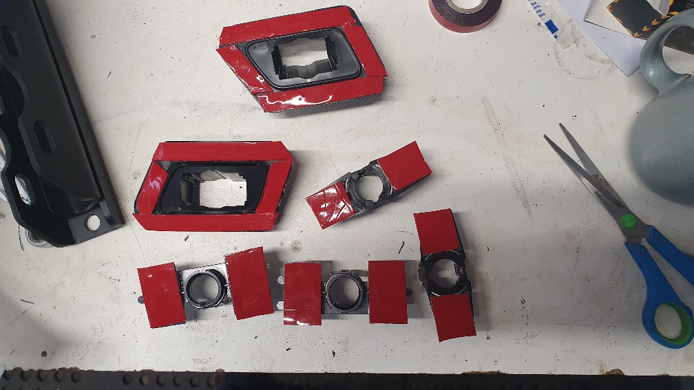

    Ok. Yes those sensor mounts were harvested from the old bar but were a really bastard to refit. The profile of that rail made it a very snug fit which sounds great but meant the mount had to be trimmed to an inch of its lige ans then very little surface area left to use double sided tape to remount. The fact you could adjust it suggests it is just hanging on to be honest. It is mounted the right way up. Get your hand in thr back qns firmly push the mount back on and see if that helps. If not then go back to the installer and ask him to fix it. I will jump on Tappa and post a couple of pics that may help you understand the back side of that. Definitely Definitely mounting issue though.

    Hi mate. Here is a couple of images for you. I have a video but need to sort it out ans upload to YouTube at some point.

    Yes you’re right The sensor is simply held on by the press fit, no adhesive. If I push it so it’s flush the sensor goes off all the time so I have to keep it recessed slightly. Question is what is the double sided tape you’re using? That might be enough for me to simply recess it enough and stop it from going off

    I used the best quality and load rated I could buy at Bunnings. It has done the job. The last pic is a screen shot from my video. You can see though in that image that the factory mount is way too big ans I had to trim a fair bit off.
    If your installer was not a Rhino Bar installer normally then I can tell you mate that they were in a world of hurt. No excuses, especially for damage, but installing this bar was a bloody Train wreck mate. Did my head in with a zero amount of online information. Rhino reckon its a 6 hour job..... it may be..... i can tell you the first one they fitted was not!! After they have done a few I'm sure they have now got a system but to a new installer I would expect it to take double that time.
