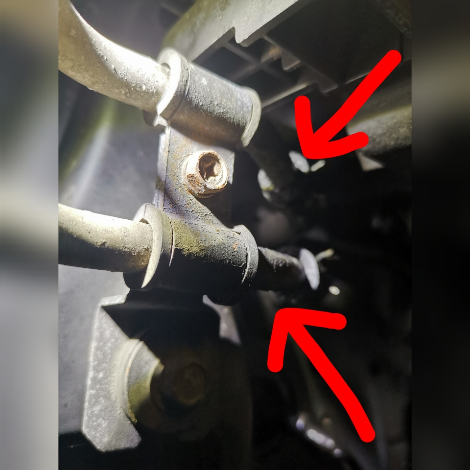

    Well I think I've found the leak source, and it appears to be the hose for what I think is the oil cooler. Is this right?

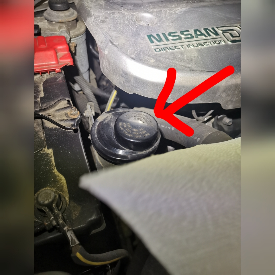

    Am I right in thinking this is fed from the small reservoir with the clip cap as pictured?
    Is it a case of replacing the entire hose or is there an alternative solution?
    Can anyone tell me what type of oil I should top up with?
    Many thanks

    Ok, schoolboy error, that's the steering fluid reservoir!
  6. #6
    15,847
    8,900
    477 Post(s)
    Follow those hoses mate and see where they lead too. If its from the power steering, the reservoir should be quite empty then. If it is, top it up with auto trans fluid. DexIII usually.
