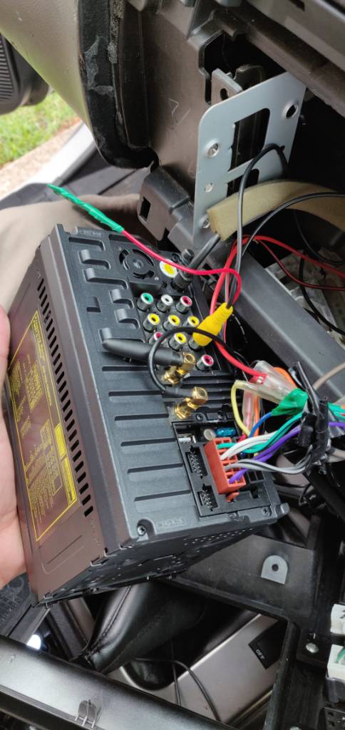

    Hi guys I've installed an Android head unit and run the wiring for the reverse camera and that's all great. But I'm having an issue where the camera isn't coming onto the screen when I put the patrol in reverse but the LEDs on the camera switch on.

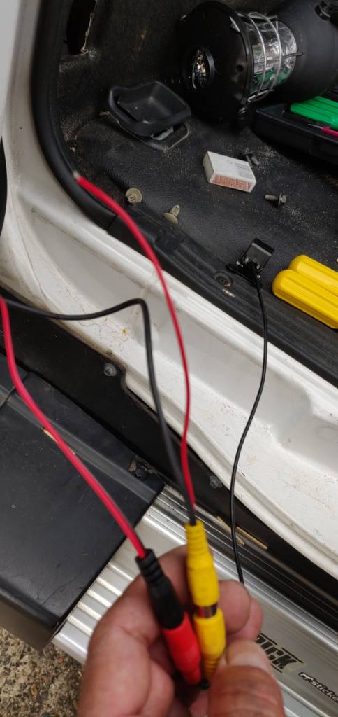

    I've got the power and earth (black connector) connected to the power and earth on the reverse light at the back and then the yellow connector going from the camera to the stereo and plugged into the correct hole (R CAM). The thing that's got me stumped is there is a red wire sticking out both ends of the yellow connector. Tried to also connect that to the power on the reverse light and it burned a fuse so I removed it.
    Would anyone know where I'm going wrong?

    i found when i used the reverse light for my power and earth i had grainy image, i used a chassis earth and the image was heaps better.
    also when the earth was on the reverse light the camer would flicker everytime id touch the brake pedal. odd hey.
    reason your screen doestn auto go to the camera could be this.
    with my head unis i have a reverse trigger wire coming from the head unit, so when in revers this wire got power and would switch the display to the camera input.
    the camera is probably working but the screen isnt switching to that input?
    with my head unit i can go through the menu and select rear camera even when not in reverse but the way mine is wired the camera only powers in reverse so doesnt work unless i re-do it.
    can you put the car in reverse and find an option in your menu to display rear camera?
    hope this helps

    The Red wires on the Vid RCA Cable is to trigger the Head Unit so it knows you have selected reverse.
    The camera end should be connected to reverse light +ve, the Head unit end should be connected to teh appropriate jack, wire or pin on your Head Unit.
    If you want only want to select the Rev Cam on The Head Unit manually then you can leave both ends disconnected ditto if you don't have a trigger jack on the Head Unit.

    salim do you have a wiring picture of your head unit, something that tells you the purpose of each wire from the plug?

    Different manufacturers don't follow a common wire colour code. So you really need to find a diagram as @Fireblade posted.

    if you do need a reverse signal for the head unit these is a yellow wire in the left hand kick panel that i used to trigger the head unit.
    im sure is was a solid yellow wire just use a test light and prob which wire lights up with reverse there should be one in the left hand kick panel
    i have a 2008 wagon right hand drive. yours may be different

    Hey mate, thanks for your reply. Yeah I might give that a go. It's weird nothing happens at all when I shift into reverse. Nah there's nothing to manually do it.
    Yep that's what I've done but what about the other cable do I remove that one from the reverse light wire?
    Yes... or at least insulate the Head Unit end.
    Personally, I would find out which wire is teh Rev Cam Trigger on the head unit and connect it up.
    What brand/model is teh head unit?
