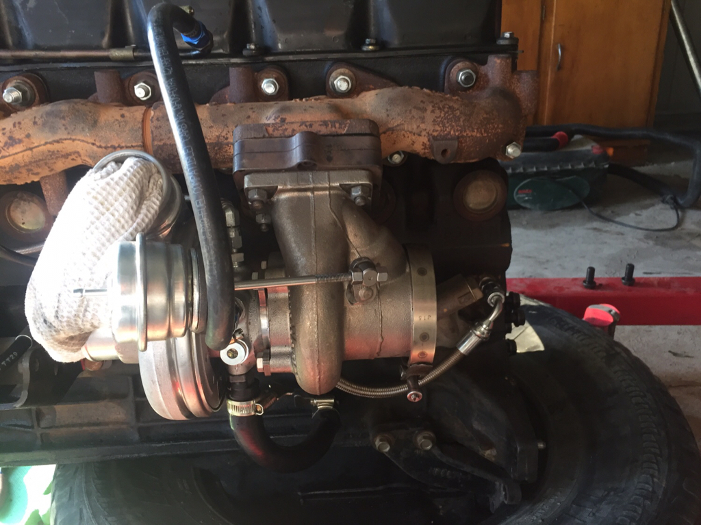

    41984449_290185098474487_928780316913434624_n.jpg42045266_2141791849392205_2973426599417872384_n.jpg Ended up making my water return into the radiator hose seems to work pretty mint.
    Thanks for all the help guys
