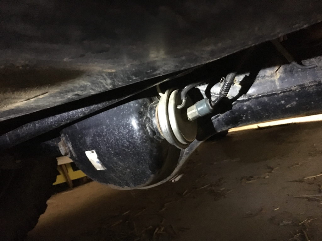

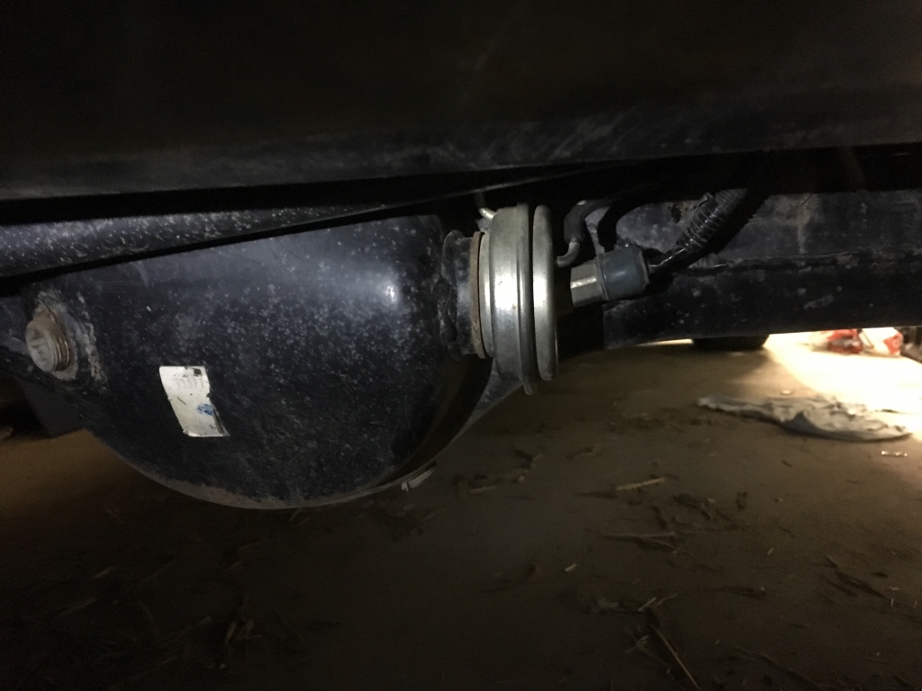

    Quote Originally Posted by Yendor View Post
    It’s a bit hard to tell by the photo, what’s a bit out of shape? The whole unit where it mounts to the diff or the connection of the bottom vacuum hose.
    The bottom vacuum hose is for diff lock off. The top vacuum hose in your picture is diff lock on.
    The vac solanoid looks ing good shape, like new really
    This is the bit I'm worried about as it's a bit out of shape
    ................on the road
    It looks like its been pushed up a bit. I will take another photo froma different angle

    Ok got it back in shape but no cigar, still not engaging.
    Thinking the vac solanoid could be the issue.

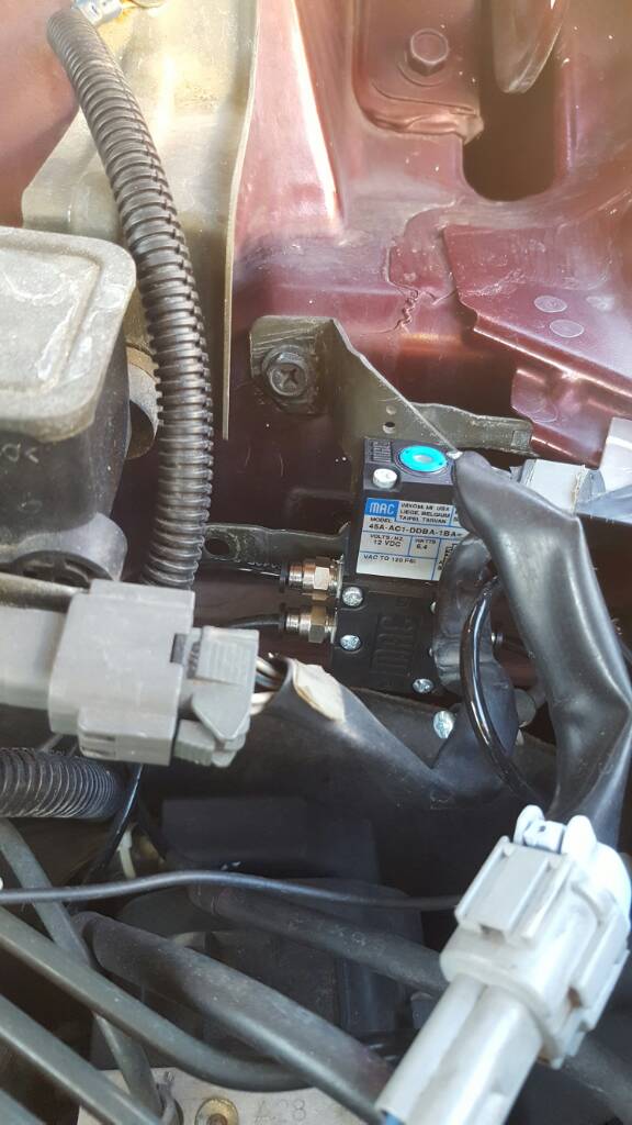

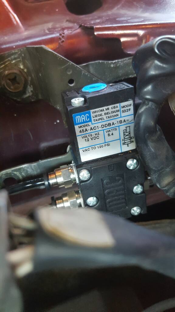

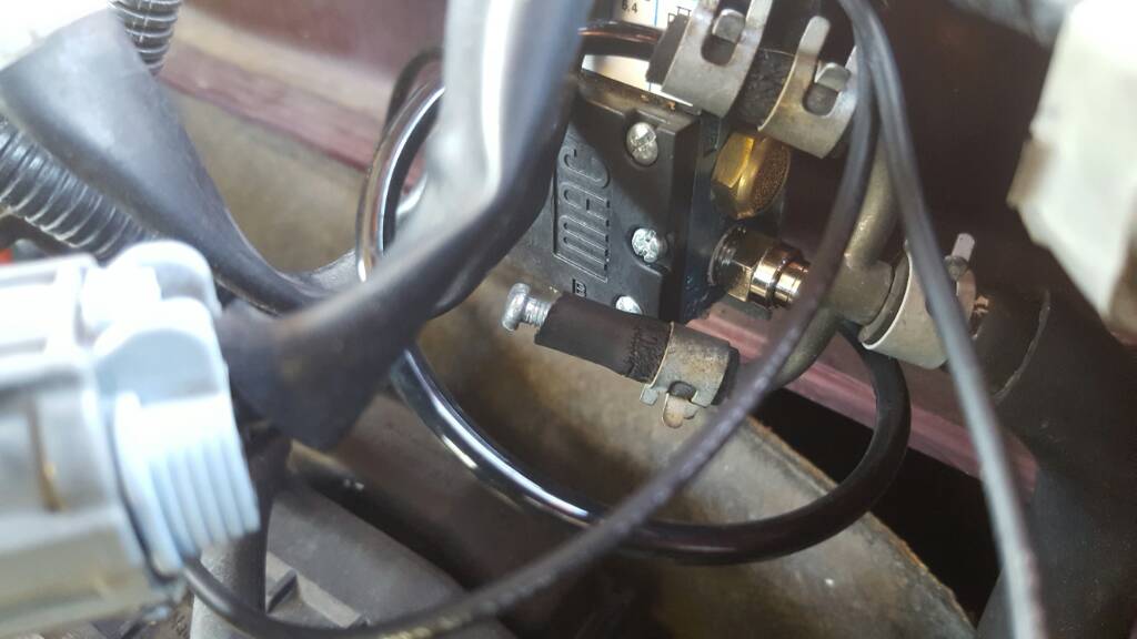

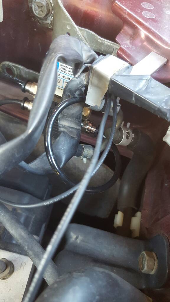

    The stock solenoid cant be fixed. They fall to bits if you try to get inside them. Nissan could replace them if need be but i have no idea on cost.
    I have attached a few pics of my MAC valve.
    I even bent the original bracket to mount the MAC onto. Some have made their own brackets to hold them. Took about 20 mins to do including wiring the 3 wires up into the original harness.
    Its dead easy
    Part number was 45A-AC1-DDBA-1BA
    I also ordered fittings to suit with it. So you will need a breather and 3 x push type fittings if you set it up the same way as mine. I think it was 4mm line I used which I ordered 1m of it. You dont need that much but I kept it as spares and its cheap.
    I rung MAC direct and they were more than helpful and overnight bagged it to me as well.
