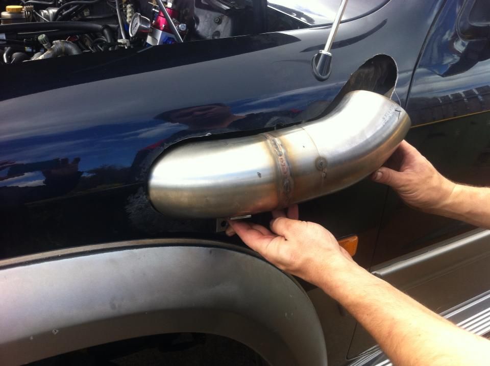

    Progress on the airbox and snorkel
    1998 GU TI LS1

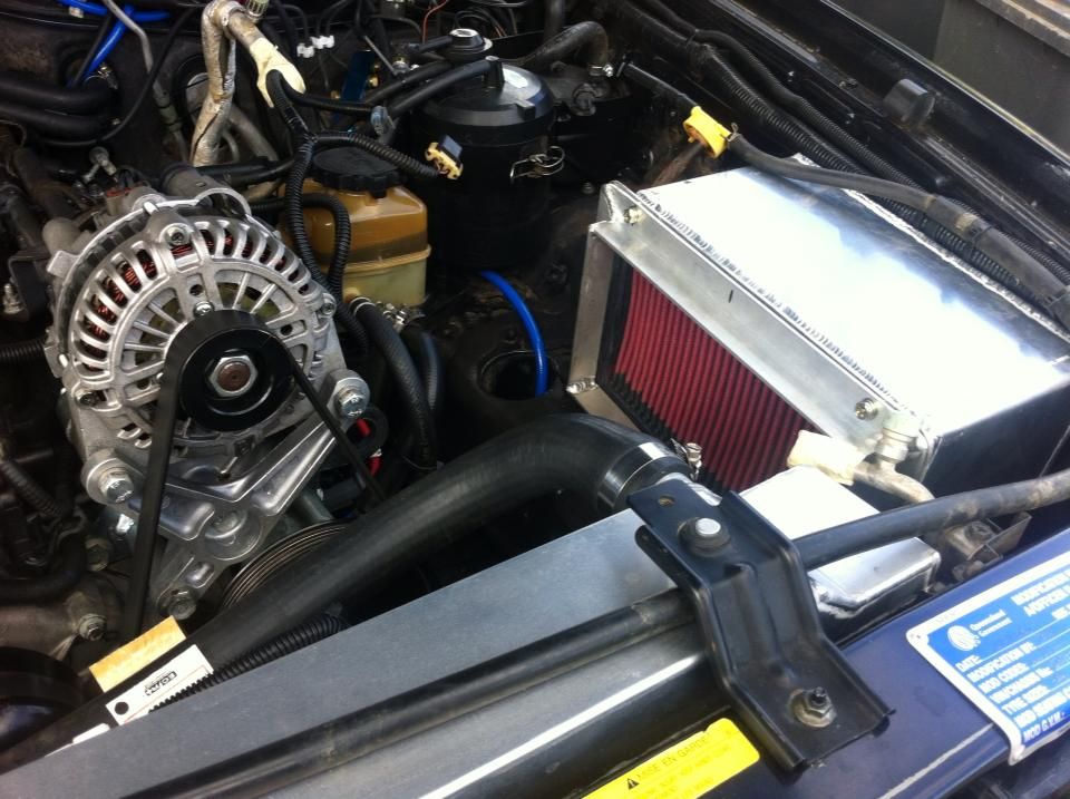

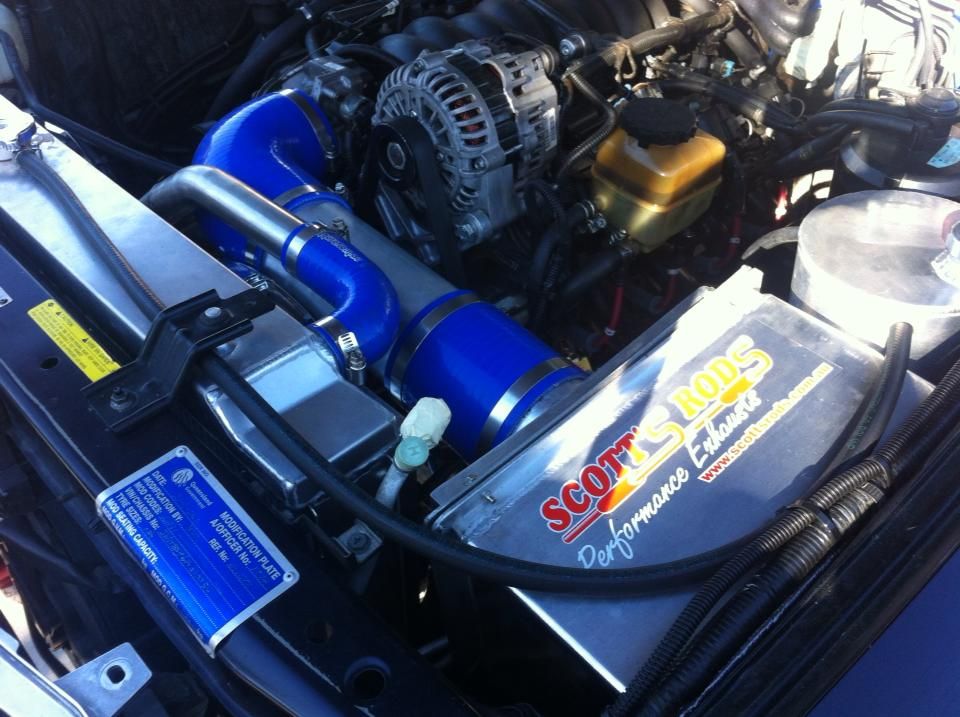

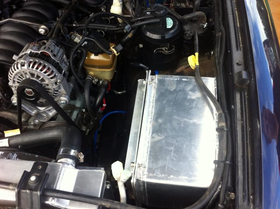

  7. #125
    Expert Thirsty's Avatar
    Oct 2011
    Raceview, Ipswich QLD
    321
    117
    Thanked 70 Times in 44 Posts
    1998 GU TI LS1
